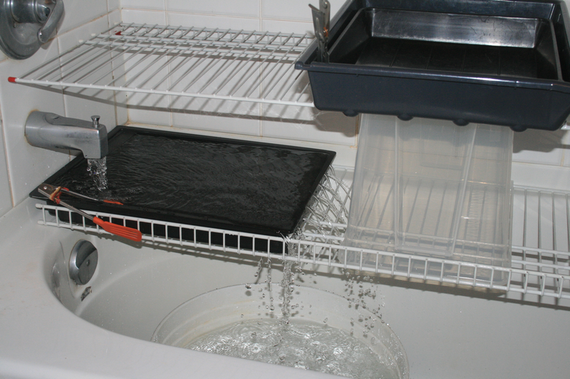

This will give you a sense of what I do for printing - the top 11x14 inside 12x16 tray is the fixer tray - the stop bath and developer trays are to the right on the top shelf.
The two wash trays - one draining into the other - are below:
