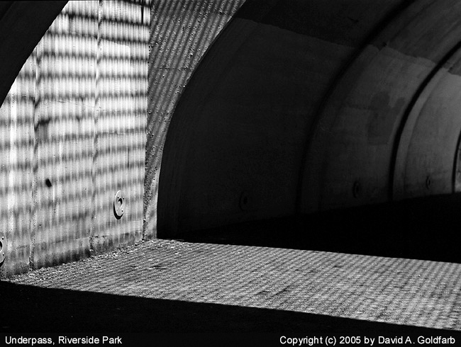

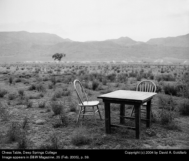

The chess table was with a 150/4.5 Xenar. The underpass was probably the 135/3.5 Planar.
