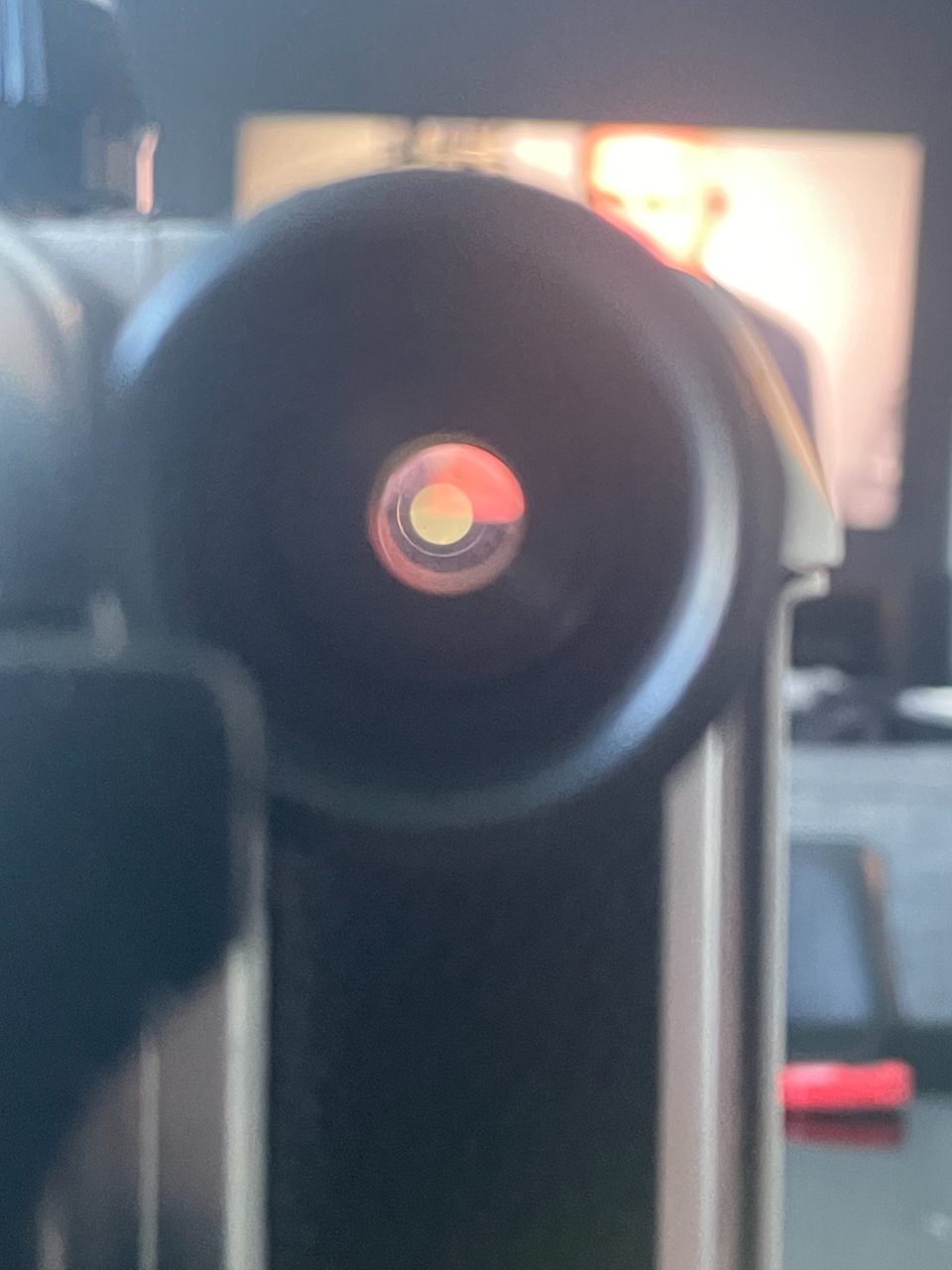

I am new to Large Format and I have a camera question. I recently purchased a Linhof Master Technika RF and I am wondering if what I am seeing in the rangefinder is a defect or whether this is the view when one is not cammed. I have a halo in the view finder that disappears when I cover the lower front lens. I am wondering if this is normal to see for it being unfocused? I have attached a picture.
I have googled with every search term possible to find out what I exactly should be seeing in the rangefinder when it is unfocused but haven't found much.
Thanks in advance for any help. I look forward to being a part of the community here going forward!
Jess

Als you are located in the USA, you have the privilege to be 'close' to one of the very best Linhof repairmen on the N-American continent : http://www.laflexcamera.com/.
He knows almost everything about Linhof, I think you better call hem and explain your issue.

If you search the Linhof user manual, it will show you where to install the focusing cam. There you can find the focusing cam linkage to the the rangefinder. If you move the focusing cam linkage, the double image in the rangefinder should move. Then you are fine.

The Technika rangfinder is a typical double image style. You don't need a cam to check if there is image forming. You can even do it with the front cover closed.
The upper lens gives you the full view, while the lower lens gives you only the view for the central patch. Cover the upper lens with your hand, and you should still see an image in the central patch. If you can't see an image in the central patch, then the rangefinder optics in the lower section are damaged or missing.
You only need to have a cam to check that the two images line up during focusing.

I was able to verify that is works by moving the cam linkage. It is not defective after all!
