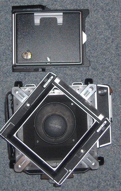

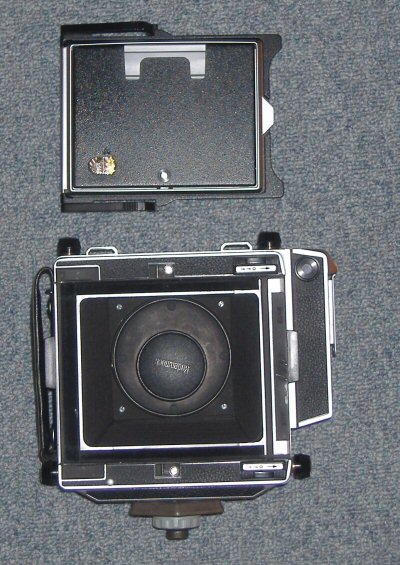

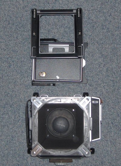

I've attached some quick images I just made of my Technika....as you can see, once you move the four silver tabs out, the back (the part that rotates) lifts right out of the camera....perhaps these will help?
Now i get what tabs are meant to be pulled out. But mine are screwed and i cant move them. I guess i have to screw that off, to get the back off. But then im afraid i wont get it in place again :smile:
Do yours glitch abit? not much, but just little, i figured that the things move, and if it to tight it wont move. I just noticed this and was wondering how much.
Thanks for the time of taking pictures to help me, I really thanfull.
Cheers Johannes
