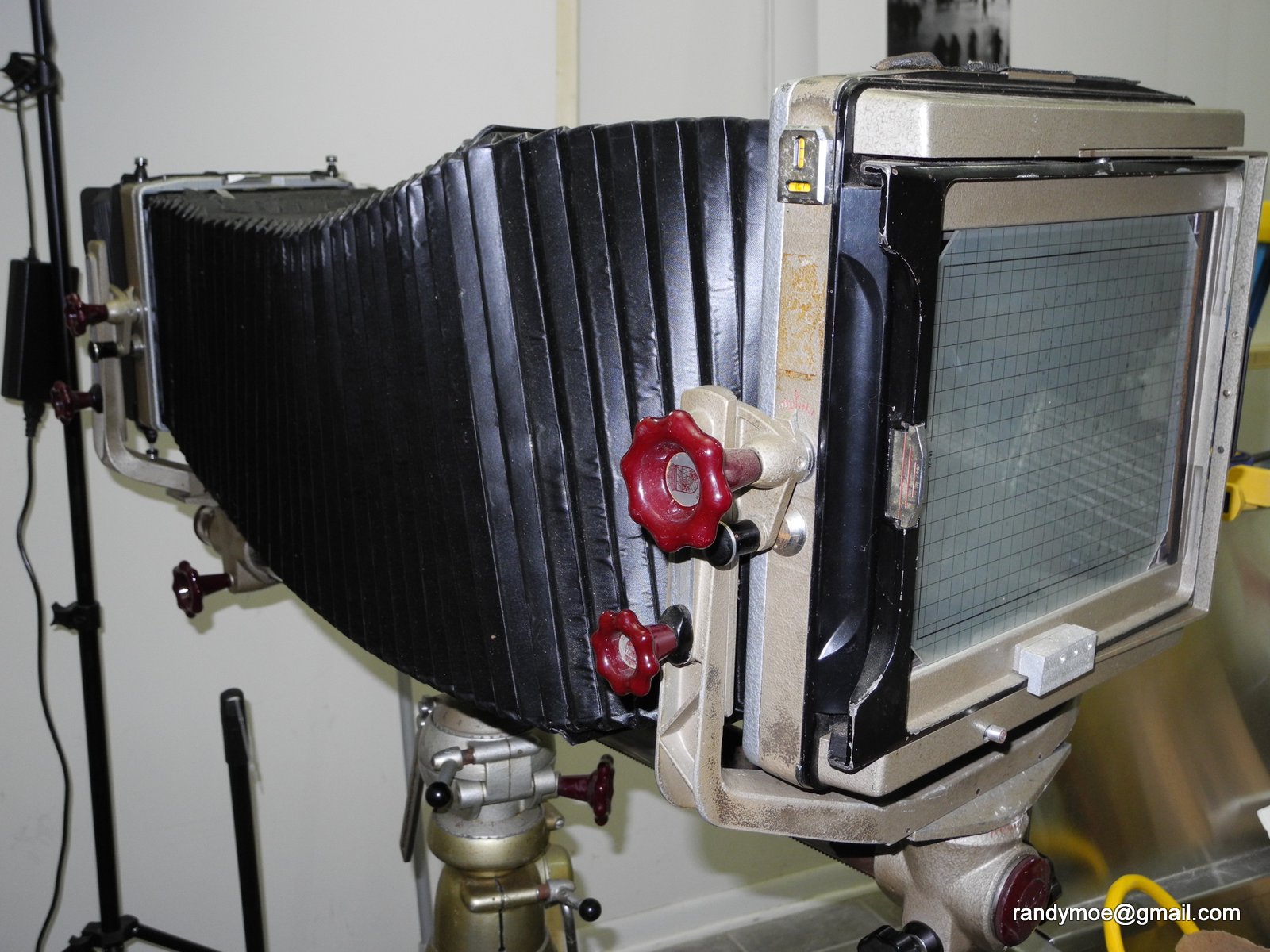

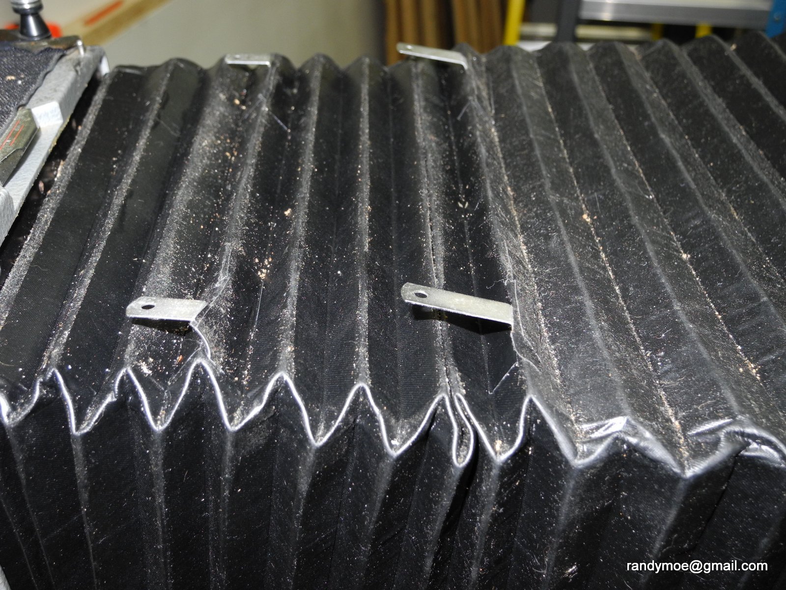

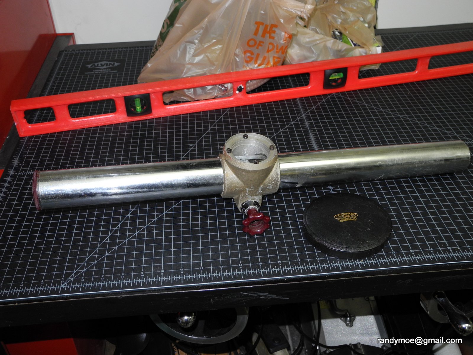

Hi, Sorry, but I am kinda excited and tired. Drove 620 miles and 14 hours to pick up a Linhof Kardan Color 8x10. i don't know much about it, but I could not resist. It is a big thing and needs work, but everything is there and really only needs cleaning and lube. Possibly a re chrome on the rail. That is it's worst feature. The bellows are good and may be original as they have little metal hooks to hang on the front standard. The compendium hood is in excellent shape. The Linhof lens is clean and the shutter? The matching frame's serial #s are 91586.
I am looking for advice, guidance, history, manual and that sort of thing. The pictures are as purchased with no cleaning. Please excuse my darkroom is under construction. I am NOT a large format expert, but I am willing to learn. I am a gearhead and former dyno test mechanic. I love all mechanical things!
Before driving all day for this, I researched all night on the Internet. I did not find a lot of info or even many pictures. Were they that low of production, or unpopular or simply forgotten?
I realize it is a monster and makes my Calumet C1 and Horseman 8x10 appear small. So what! It is a show off piece for studio portraits. If this thing doesn't scare a sitter, I will have to move up to? 06-DSCN1192.JPG08-DSCN1194.JPG09-DSCN1195.JPG07-DSCN1193.JPG12-DSCN1198.JPG

Nice. One sees a lot more of these 1970's era Kardan Colors in 4x5.
First thing to be aware of is the operation of a Compur air braked shutter. Don't try to cock the shutter and fire it on the B or T settings, or you'll strip it. You only need to cock it for the timed settings.

Thanks for your advice. I will buy the Linhof book. The shutter was barely saved. The seller, forgot how it worked and I did not know. I stopped him from any abuse and got away clean. I just followed your advice and B&T work fine. The speeds vary, but 1 second is fast. Perhaps it needs some exercise. The seller claimed this rig was last used in the 80's. Aperture works fine. The elements are clean and unscratched. I assume one removes the rear element for the double effect...I will bother Bob Salomon when I have some real problems. Like parts!

Thanks for your tips. My camera did come with the big twin spar tripod. The whole thing is quite impressive. I am going to have the monorail re chromed and polish the rest. I am your age and retired. I never got beyond shooting a Pentax H3 until a few years ago. It was all I needed, until digital... I now enjoy collecting very affordable film cameras in all sizes. As a collector, there is no rational explanation for what I collect. For example, in my time I have bought, rode and sold at least 200 motorcycles. As my friends have always been quick to point out, I can only ride one at a time. The same goes for cameras, almost. I have shifted my focus to camera collecting, a better hobby for an older person. I will never shoot some of my cameras, nonetheless I enjoy them and display them. Life is short and rationality is way overrated. Why else would I be building the darkroom of my dreams, now? Because I can. I won't discuss my enlarger collection, but suffice to say they are even cheaper than cameras...
