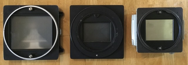

Linhof Technika 4x5” and 2x3” backs both have a circular mount and rotate, but they are different sizes. Measuring the rear plate, a 4x5” back is 158mm square. A 2x3” back is 123mm square. If the groundglass is 4x5”, then it’s a 4x5” back, though there is a rare 2x3” back for the 4x5” camera.
David A. Goldfarb
Sep 7, 2002
19,974
Honolulu, HI
Unfortunately, my 2x3” Tech V is in the shop right now, so I can’t post an image of the groundglass back, but I have a 2x3” rollfilm back on hand, which has the same rear plate as the groundglass back. The back on the left is a 4x5” groundglass back for a 4x5” Tech IV/V/MT/2000/3000. The back in the center is a 2x3” groundglass back for a 4x5” Tech IV/V/MT/2000/3000. The back on the right is a 6x7cm rollfilm back for a 2x3” Tech IV/V. I’m not sure that these backs will fit earlier cameras like the Tech III.
