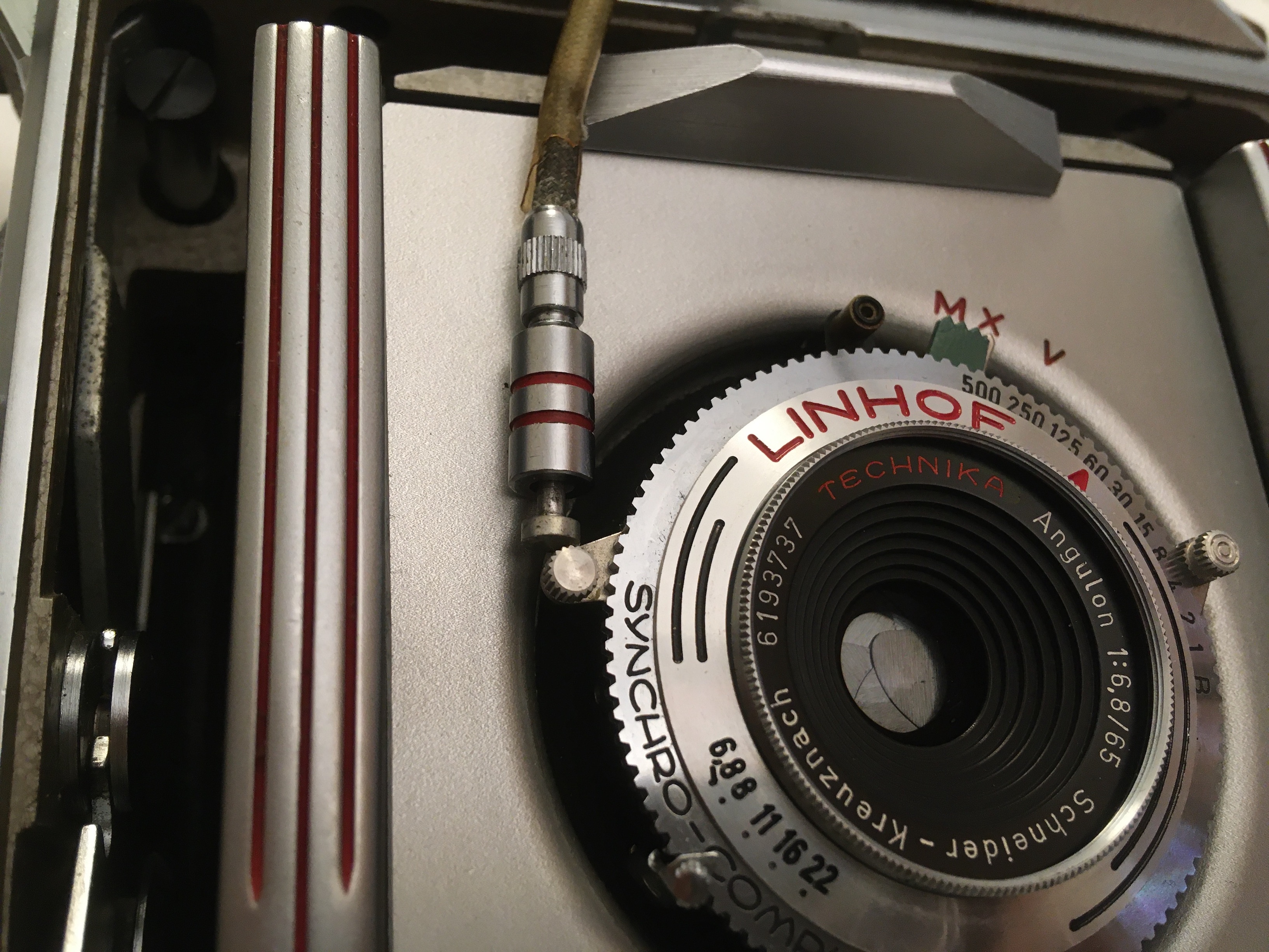

There seems to be some friction in my shutter release cable that prevents the shutter release lever on the lens from returning after an exposure (see below image). The shutter release cable is fine when perfectly straight but doesn't return properly when there's a slight bend in the cable.
Is there any way to lubricate a shutter release cable? I'd replace it if it wasn't a Linhof cable made to lock into the anatomical grip.

Perhaps, first clean the tip and the nipple which is in the holder near the lens with some lighter petrol to dissolve the older lubrication which might have stiffen over time. The yellowish/brownish precipitate one can see in your picture indicates older grease (and some dirt sticking in it too)...
