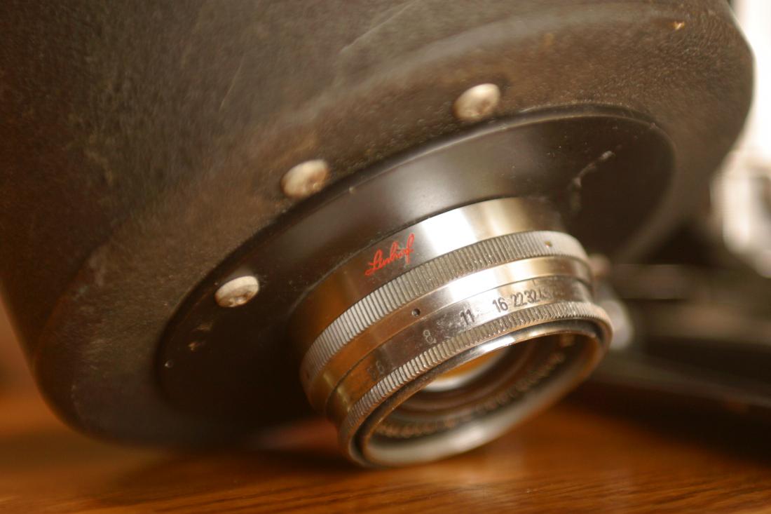

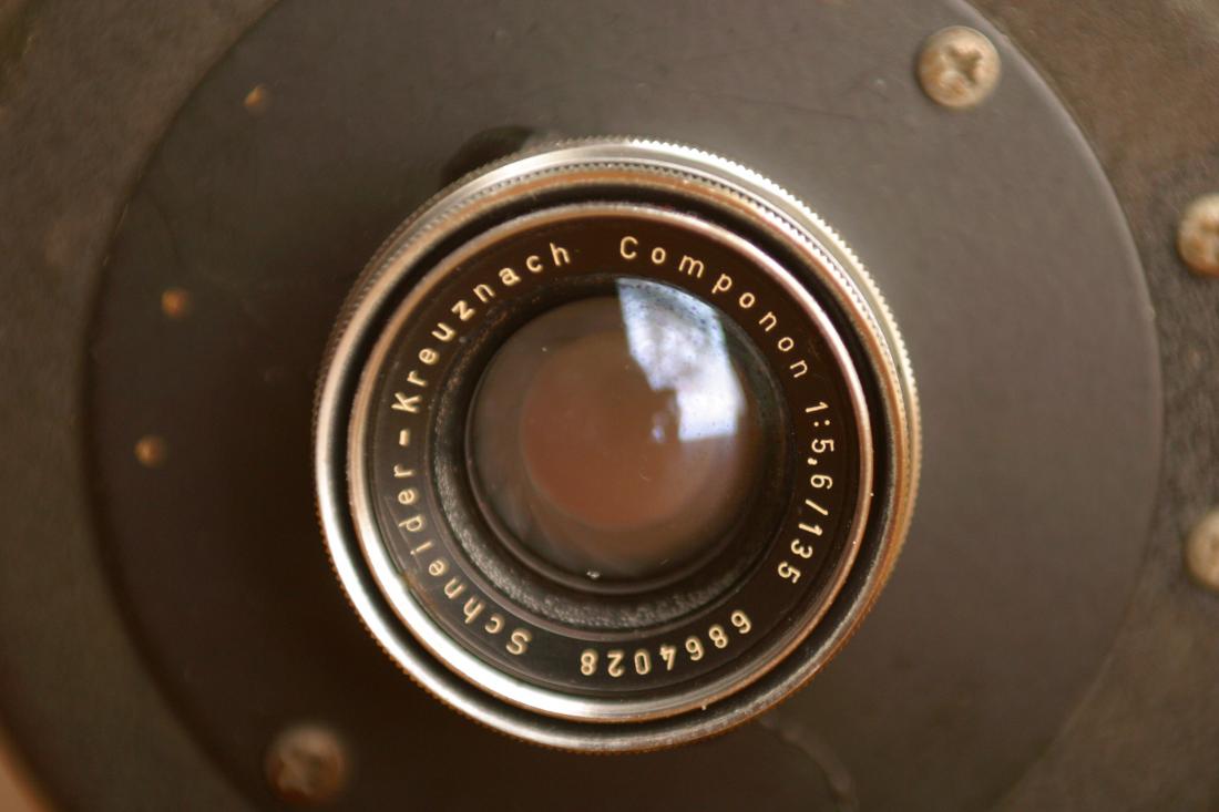

135mm Linhof Componon
:rolleyes:Ian, this particular lens looks just like a Schneider Componon 135mm f5.6, but it has Linhof red-engraved on the outer barrel. Maybe the whole lens screwed into some sort of shutter. I'll take a picture of it later and post it. JohnW

That's unusual* as it's a Linhof barrel, so it's original - I was wrong. It's also unusual as the Linhof name is usually on the ring inside the filter thread, I have similar age Durst Componons marked that way and Linhof select LF lenes
You'd need to look at what else Linhof made in the 60's/70's, try the CammeraEccentric website he has a few Linhof catalogues online. I know that my CZJ 150mm Tessar was being sold at one time as a Linhof lens (rebadged by Zeiss West Germany).
Ian
* or is it ? some things nagging telling me my old 135mm Componon might be similarly marked, but it's in the UK
It is possible Linhof supplied the barrels.

Ian, I'm thinking more along the lines of a mutual partnership. Maybe Schneider was contracted to produce the lens with the Linhof trade mark. The reason I say this is because the barrel certainly looks "Schneider" to me. Of course I could be wrong? Being wrong is certainly possible for me and my wife is quick to point that out. JohnW

Why would Schneider necessarily make all the barrels etc, all their camera lenses fit shutters, at that time mostly Compur or Prontor, although some for Sinar shutters are non standard.
The first Schneider made lens I saw in a composite barrel (nin metal) was actually a Vivitar 150mm f5.6 VHE, the lens cells are marked Made in Germany, and soon after that Scneider switched as well, but they may have had the barrels made elsewhere.
Deckel/Compur came up with the modern shutter standard sizes, still in use today, in 1929 so maybe they made matching barrels in the same size for Schneider,
It's a strange one, but companies s do & did sub contract, the only camera/optical company that made every single component was VEB Pentacon.
