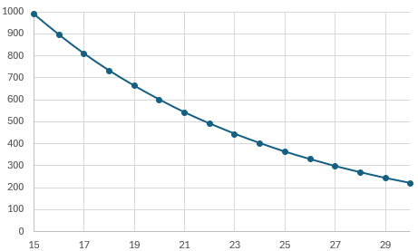

No, it's exponential in principle, but the curve shape is inconsistent, dependent on the materials used and even for the pure exponential part it will vary with film/dev combination.

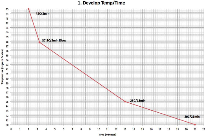

Here's a chart based on C41 developer time/temperature data Rollei used to include with their Digibase kits:
Chart taken from here: https://www.lomography.com/magazine/236651-tutorial-rollei-c41-digibase-color-film-development
I made a similar chart once based on the same data but did a curve fit so I could easily interpolate time/temperature combinations.
Mind you, in the case of color development different time/temp combinations aren't perfectly equivalent since there will be differences in the rate of development in the different layers. For B&W, this is likely not a problem, although non-linearities do exist as I alluded to above. The further you stray from the regular 20-24C temperatures, the more unpredictable it all gets.

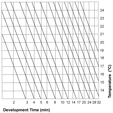

A possibly easier reference is the Ilford time/temperature compensation chart found here: https://www.google.com/url?sa=t&sou...QQFnoECBUQAQ&usg=AOvVaw28z9G_BEEGBVcIDnTqV6xZ
It should apply to all black-and-white films closely. Keep in mind that some developing agents lose activity if the temperature is too low and, on the upper end, emulsion softens and flakes off if the temp is too high.

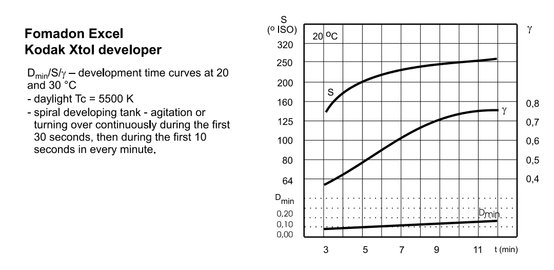

If you're using stock, you could use the official times in the manufacturer's data sheet for Fomadon Excel at 20 degrees. Here they are - page two, first column, third row
https://www.foma.cz/en/fomapan-400
Normally, you would aim for a desired target gamma, but you seem to need a specific EI. So do as I sketched below, but in the opposite direction:
So pick a target ISO from the vertical axis on the left. Trace a horizontal line towards the top curve (S curve). When your line meets the curve, trace a vertical line going down, to meet the Gamma curve and the X coordinate.
The value you'll read on the vertical right axis will be your gamma value. The value you'll find on the X coordinate will be the development time needed.
E.g at 20 degrees Celsius you can see that with Excel stock you'll be getting a g~.5 if you expose at 200EI and develop for 5 minutes.

I almost get it. I get how I find my developing time from selecting an EI, but you have me curious about the rest of the graph.
What do the gamma values tell us, are they in relation to something? Gamma 0.4 would be a very dense negative that would produce a very bright print? Would gamma 0 be completely black with zero transparency? Does gamma 1.0 have any special significance? Why do the curves flatten out at ISO 320, is it actually an ISO 320 film?
