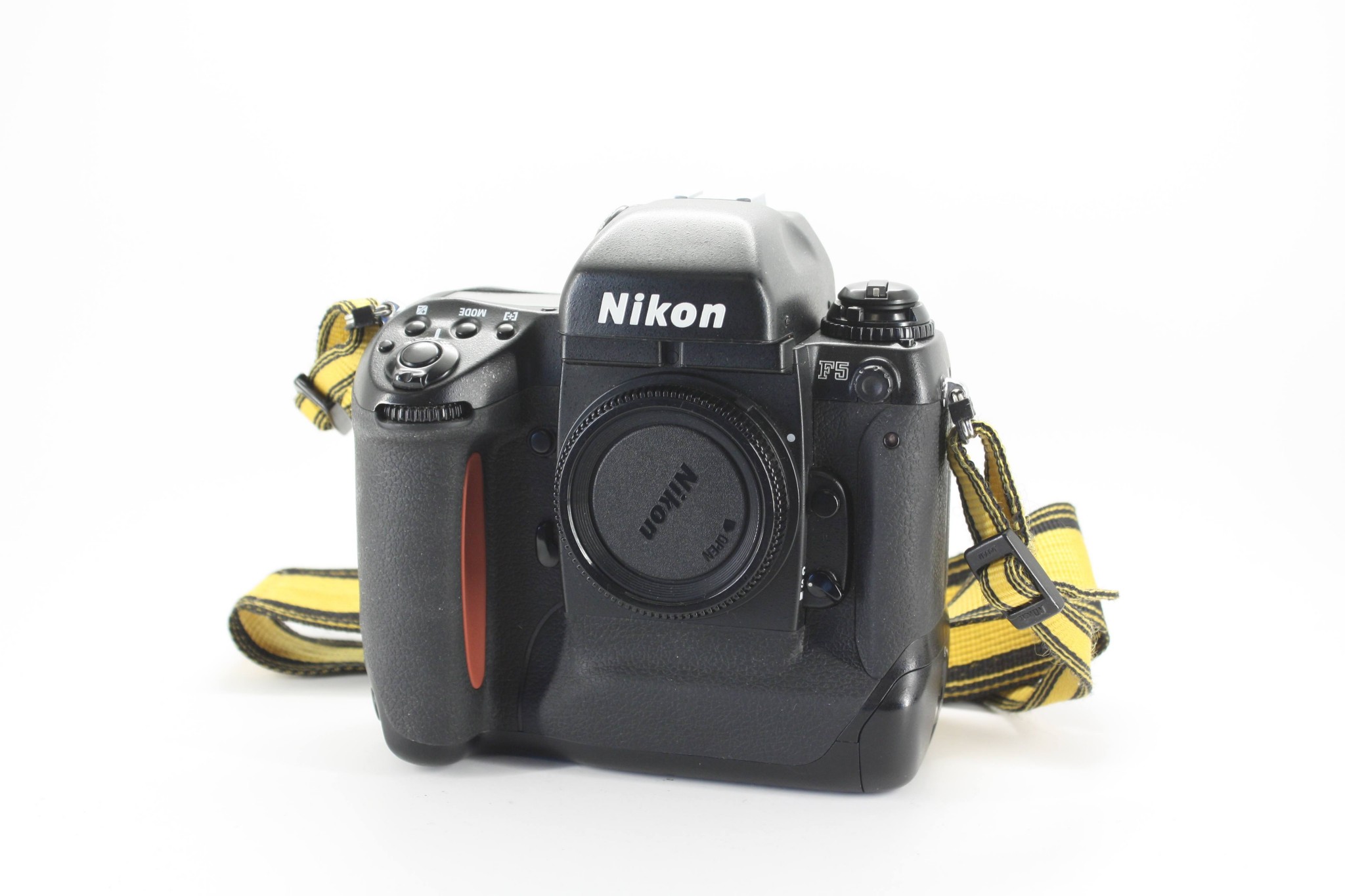

My point and shoot. Available used for under 300 usd
