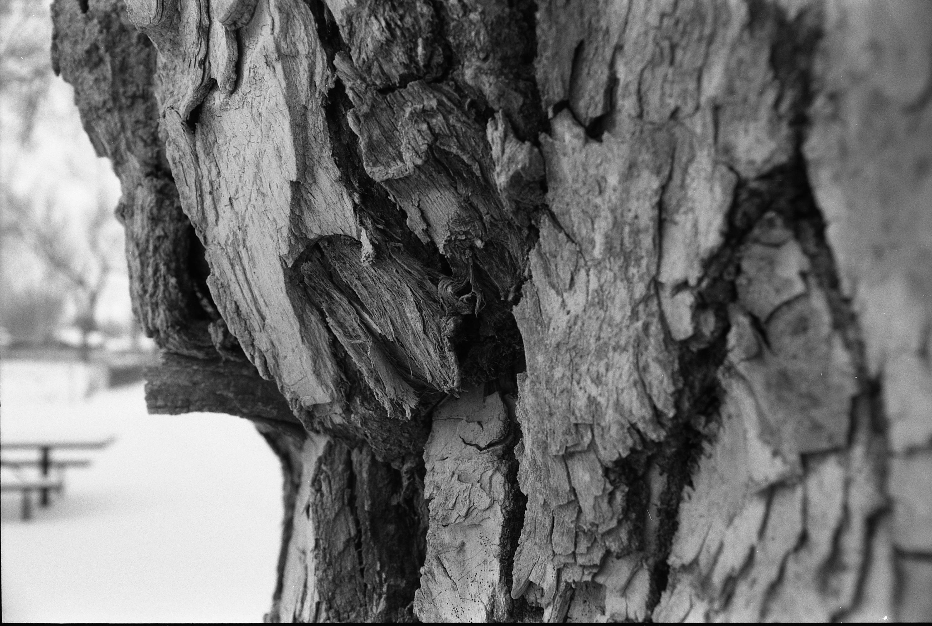

Hi,
I just finished putting a new focusing screen in an old X-700 I have and decided to go try it out. I also recently switched from using HC-110 for everything ( Mostly FP4+ and Delta 400 ) and switched to XTOL. So far I'm really liking the XTOL. I have not played with adjusting the time to optimize development and have just been using the Kodak times for rotary tube and 1:1. It seems to me the published time is working well. I've attached a couple of pictures ( FP4+ ) from today and would like to hear any thoughts on if I could benefit from tweaking the time. Please excuse the dust in my scans.
Joel

Joel, For that scene I'd say your darn close to hitting the nail on the head. If not dead on. Your shadow look fine and you retained nice texture in the snow also. I assume it was an overcast day? John

It was an overcast day, not too bright out. I have been pleased with the XTOL/FP4+ combination.
Thanks
Joel

I have used XTOL since it was launched and love it. Your images look fine to me and I would leave it like that for a while and see how you get on. Make changes later with times and dilutions only if you feel they are needed.
