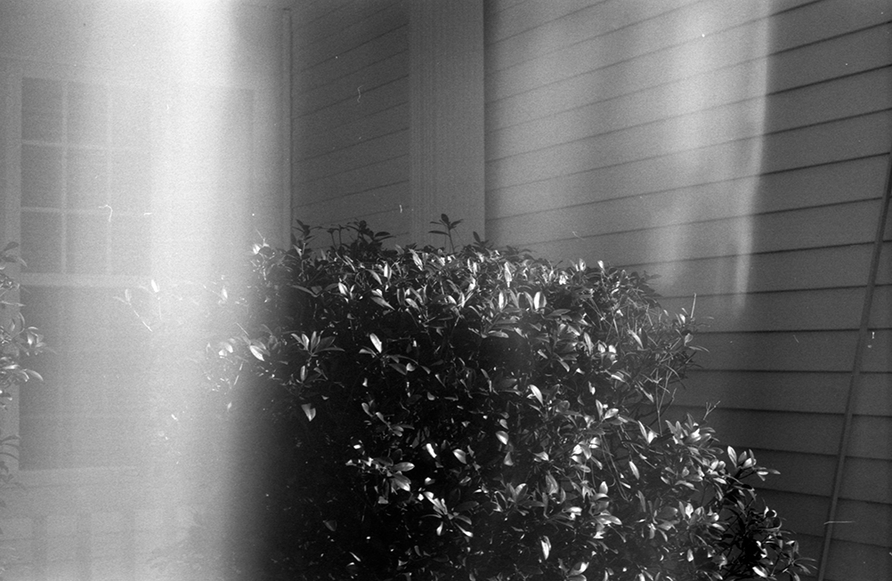

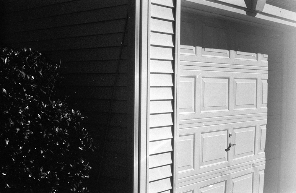

I picked up a very nice N2000 for cheap earlier this year. I only had time to run one roll of film through it after buying, but it appears to have a serious light leak. The test shots below were made in sequence, mainly as a test of the aperture priority system. (Please don't judge them for artistic merit!) The noontime sun was coming from the right of me. I stepped forward and turned slightly to the right in the second exposure. Some help determining the possible leak site would be helpful. You folks were great at helping @zanxion72. I thought it might be from the door hinge seal. Possible?

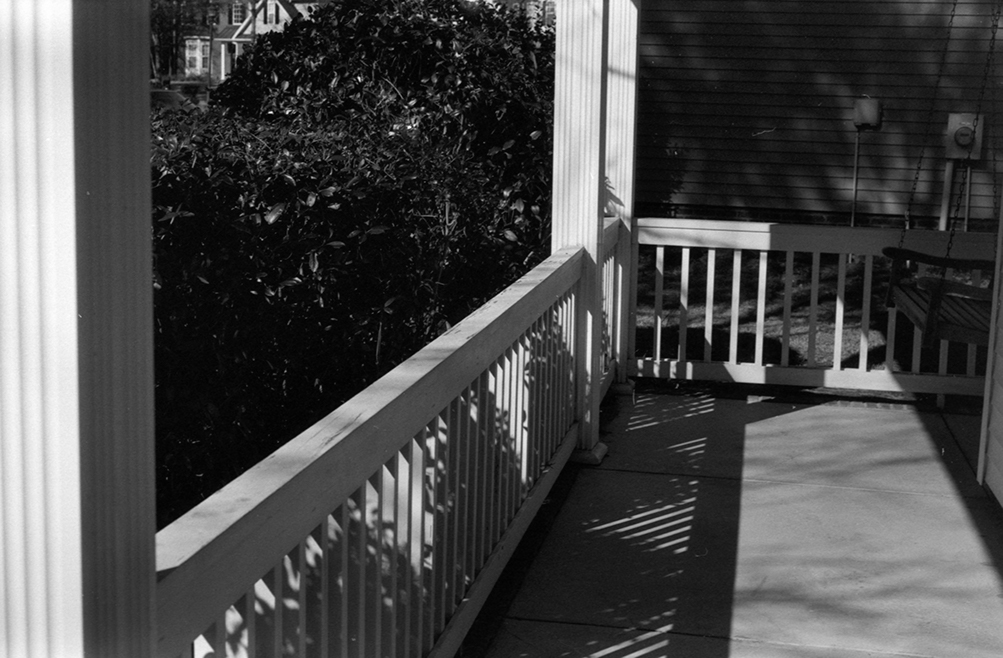

This is from the same roll, an earlier shot, made about 15 feet away with the sun behind my left shoulder, just about 90 degrees.

Maybe need for new foam light seals on the back, where the door closes, particularly along the top edge of the opening.
It could be along the sides as well, since leak seems to move from left (right seal) to right edge (left seal) of the photo

I picked up a very nice N2000 for cheap earlier this year. I only had time to run one roll of film through it after buying, but it appears to have a serious light leak. The test shots below were made in sequence, mainly as a test of the aperture priority system. (Please don't judge them for artistic merit!) The noontime sun was coming from the right of me. I stepped forward and turned slightly to the right in the second exposure. Some help determining the possible leak site would be helpful. You folks were great at helping @zanxion72. I thought it might be from the door hinge seal. Possible?]
Looks like you need new Light Seal Foam. I buy mine on Amazon.. Its $9.99 for a 9x4 sheet of foam. It works great
and easy to cut. I resealed all 10 of my Mamiya and Yashica TLR's.

The two places this model can leak light into the film door is the hinge seal, and the film cartridge window.

@Horatio Do these leaks extend outside the picture frames? If yes, it can be two things, the deteriorated foam at the right side of the back just in frond of the door hinges, or light leaked through the film canister. Could you please post a photo of the inner of the door? Most likely the culprit is with the light seal on it.

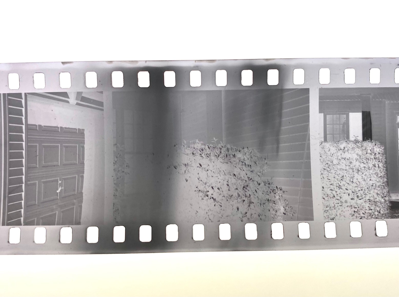

Ok. Here's the negatives in question. It seems to run from edge to edge and bleed from one frame into the next.
I checked the inside camera face and it has foam all along the channels, from end to end, though none is flush with the surface. I also placed an empty cassette inside and closed the back. I then set the camera in bulb mode, tripped the shutter and shone a flashlight all around the joints and film window. I could see no leaks. I'll try again later in a completely darkened room, just in case it was too faint to detect with my face blocking the lens mount.

looks like the light tight seal at the door hinge may be at fault here.
