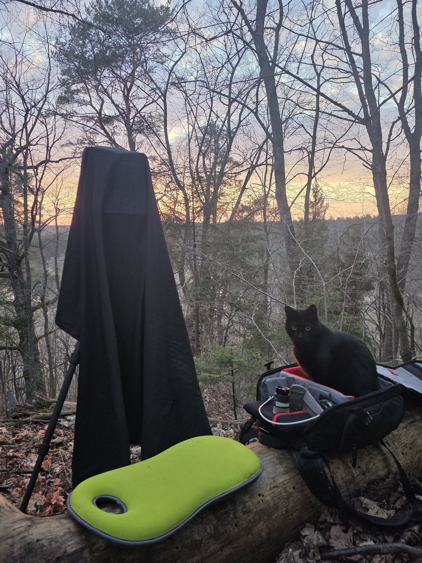

I own, but rarely use, an extremely light weight Ebony dark cloth. While I love the weight, I find it difficult to manage in even a slight wind, so it stays at home pretty much all the time.
The moral is that too light and too heavy can both be problematic, but in different ways.

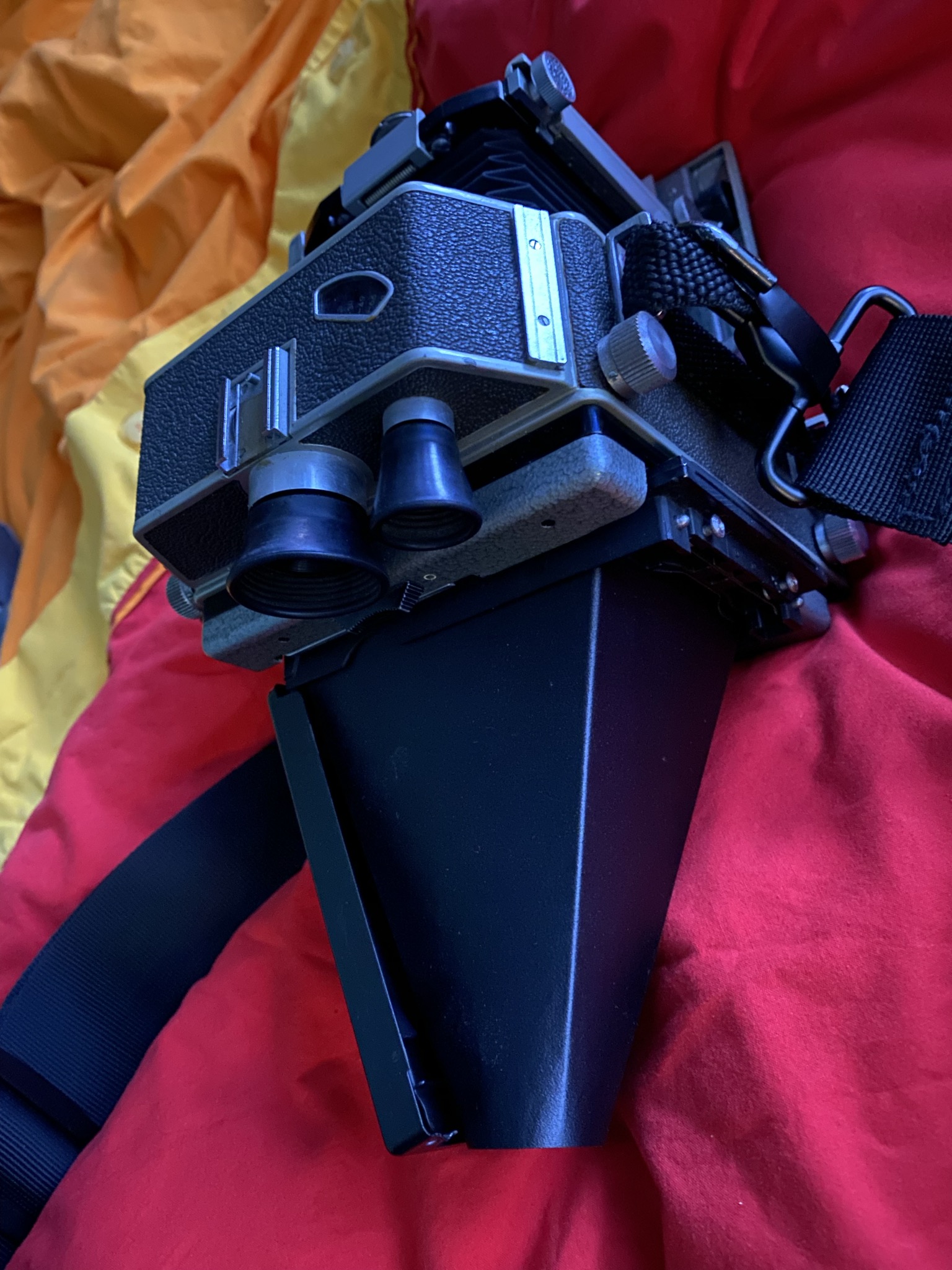

I made a focusing hood and had it printed in CF-PETG. It friction fits into my ground glass holder. If you do it this way you design it in CAD by doing a simple Loft between a circle and a rectangle, it allows you to decide how long you want it - corresponding to the diopter strength you like, then mount the diopter in the viewing hole. I went with a +4 diopter for a 127mm length. The upside to the rigidity is immunity to wind, the downside is it takes up more space when you put it away.

I made a heavy dark cloth then years later bought a light weight one. After being frustrated with the wind blowing it around, I went back to the old hand made heavy cloth.
