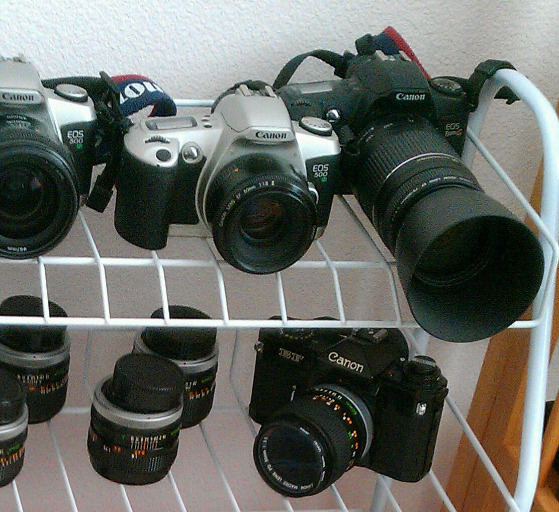

Lightest has to be this: Canon Rebel G (500N) with EF 75-300/4-5.6 III USM (supposedly their worst lens - it does feel cheap -- but image quality is acceptable).
Amazingly light outfit.

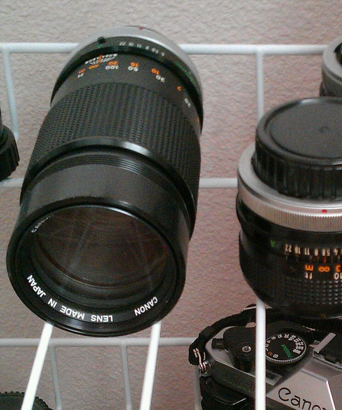

The FD 200/4 SSC is much heavier. FDn version is probably lighter.
