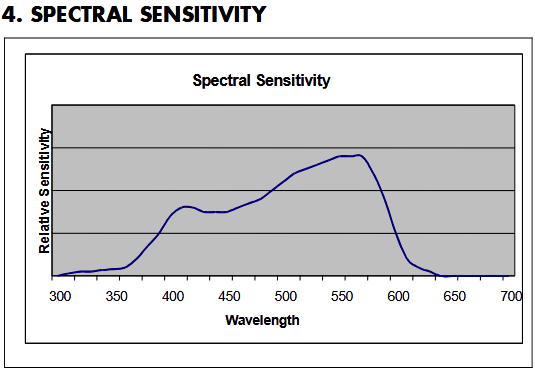

Which paper are we taking about? This is the spectral sensitivity for e.g. Harman Direct Positive:
As you can see, it's orthochromatic and even almost panchromatic with sensitivity extending to ca. 625nm (orange-red).
Sensitivity to UV is actually quite limited, so you're much better of exposing this paper with visible light.
