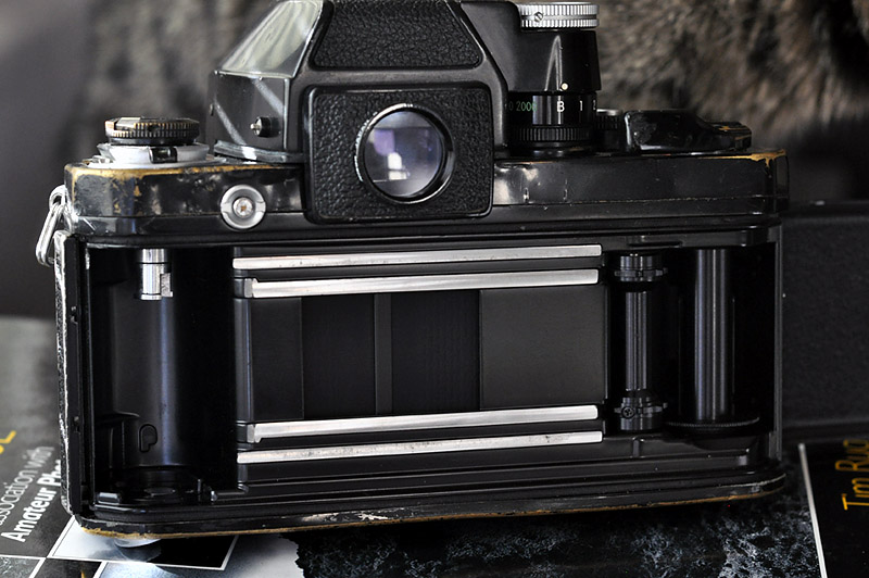

Here's a shot of my beater F2 with the shutter half-way advanced.
