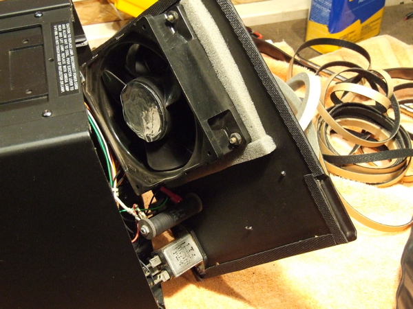

You can get adhesive-backed strips of foam rubber from McMaster Carr in various sizes and thicknesses.
