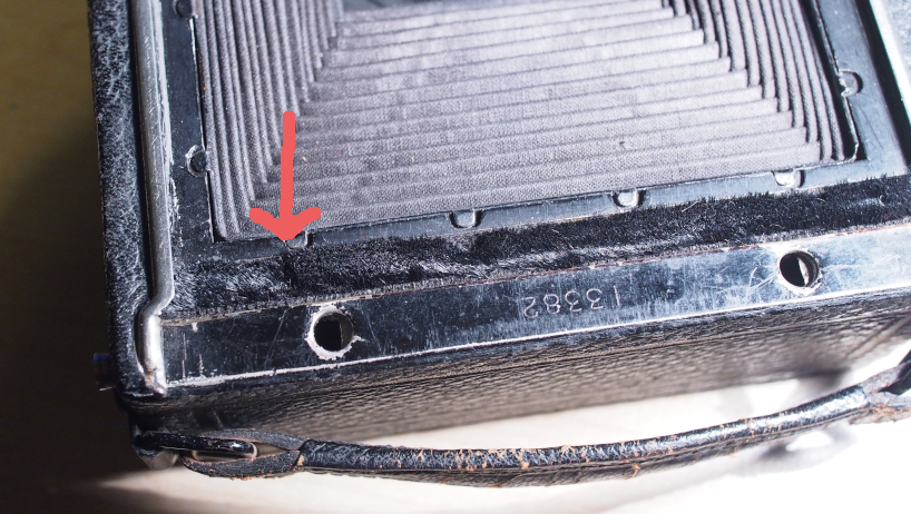

Has anyone found a good replacement for velvet light seals that's the right thickness and is available online? Figured I would check here before going out to the sewing store..
This was pretty easy to track down on the 9x12 Certotrop. the lens is removable so I could just take the lens off and look directly into the body while shining a flashlight around the outside, showed up right near where I was seeing it on the negatives. There's only one small spot where it's worn enough to let any light through.
