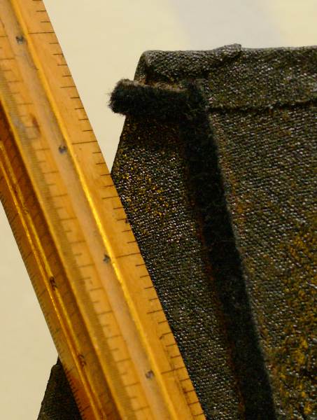

Wow, what a beautiful creature! I think the kind of mohair I have is not from the genuine mo, but I'm pretty sure that is what it is called. They used to use it for automobile upholstery etc. I doubt that was genuine sheep, but maybe it was.
The image I'm attaching shows it as used on one of my weird cameras. The scale that is nearest it is in inches. The smaller divisions are 1/10". I regret being unable to find a handy metric scale. There's one around here. Somewhere.

MXP
Apr 29, 2008
32
Copenhagen
It looks like some good stuff you have. Better than foam in many cases.
