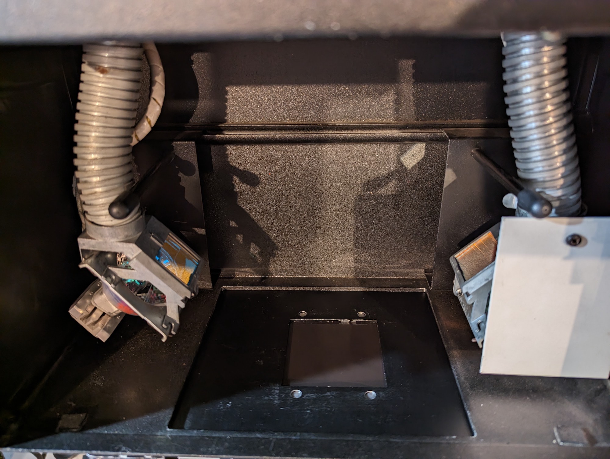

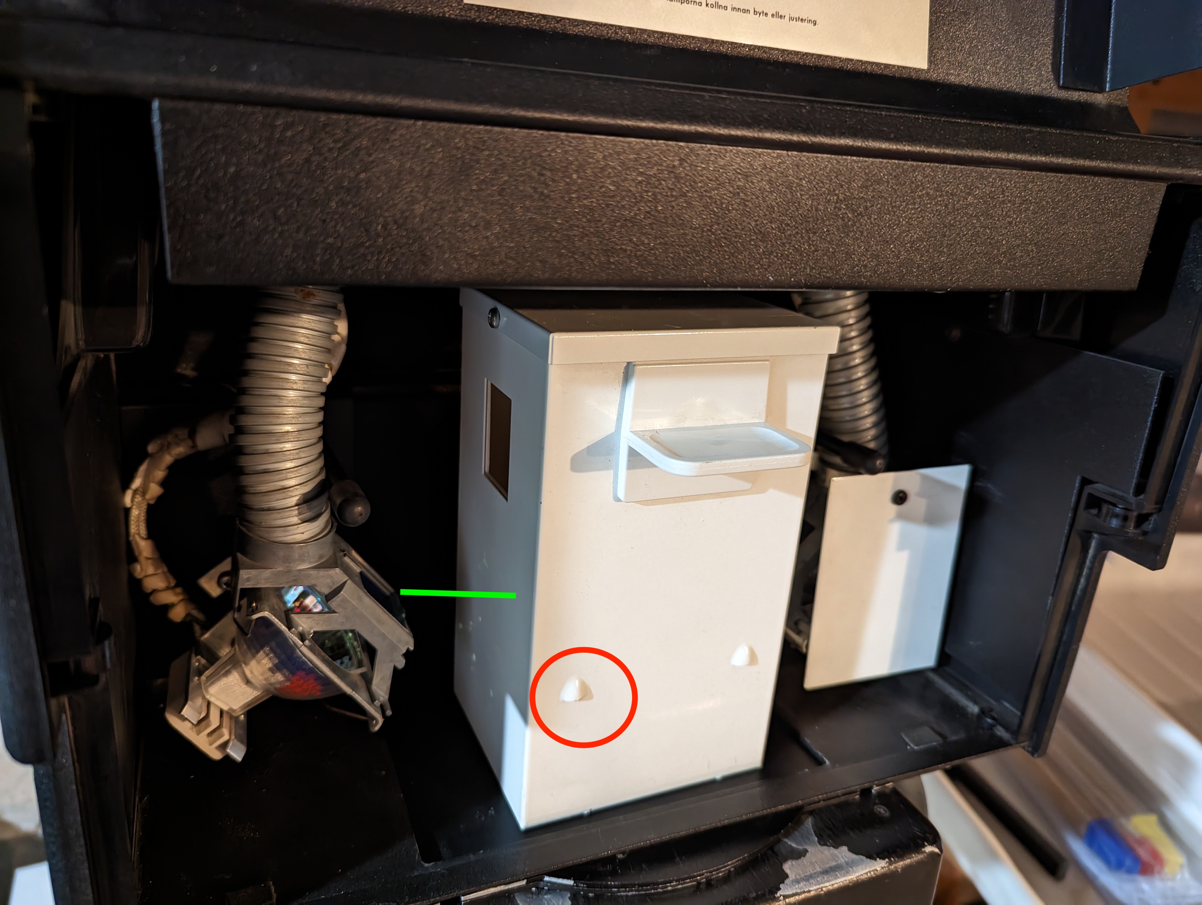

Found this thread, hope it is still alive!
I've recently bought 500H and have a question about light boxes and how to correctly position the lights.
What concerns me is the way the light box is built. The tabs (in the red circle) are not touching the register plate and the light hole seems to be somewhat far from the mirror. I've tried printed few prints and they seem to be fine. Any advice?

Welcome to Photrio.
It looks to me like that box is upside down - the top is down, and the bottom is up.
Hi,
It looks to me that the box is incorrect for your enlarger...it looks too tall.
The windows in the side are supposed to line up with the lamps, and the circled "stops" should be at the level where they meet the black metal plate.
The white diffuser plate looks like it would be way down in the bellows, below the negative stage, with that box.
Which enlarger are you using the 500H on?
Could you be missing a "spacer" between the negative stage and the bottom of the Multigrade head?
There are fitting kit manuals online which would show the correct parts for each enlarger. I have one for my L1200's.
I don't think the mixing box is upside-down, but it could be the wrong box for the film size. Those tabs are supposed to sit on the base register plate and keep the diffuser base of the mixing box off of the film holder.
Mike
Yeah, seems like it. The Multigrade head should have a T-shaped profile if you look at it from the front, with the vertical bar of the T being a 'chimney' of sorts that positions the light source at a set distance above the negative stage.
The mixing chamber extends into this chimney.
