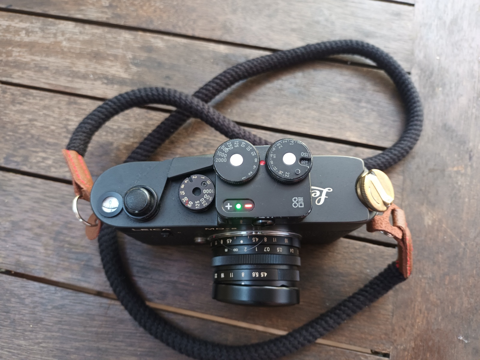

This is what I use, metal construction, two positions for shoe connection, battery lasted two years, very quick and easy to operate, can set your camera from above as I prefer, works in strong sunlight (some LCD screens are hard to see in sunlight), comes in sexy black and brilliant silver, costs less than $100.
AnselMortensen
Jun 9, 2020
2,258
SFBayArea
Traditional
Who makes that?
The logo is indecipherable.
Thanks.
