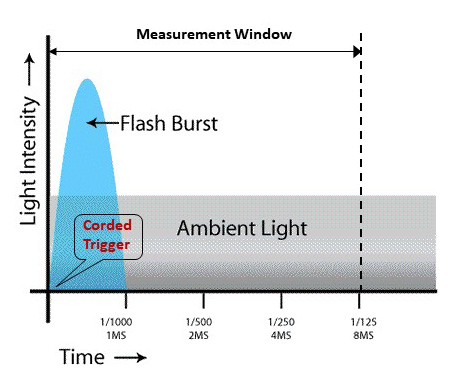

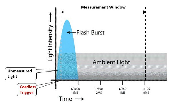

One further and related question comes to mind regarding the difference between the meter's corded and non-corded flash modes. The meter integrates all light detected during the speed set. In corded mode with a sync cable connected to the flash (or a wireless trigger), the meter likely triggers the flash at the beginning of the time set and continues measuring until the end of the window.
In non-corded flash mode, the meter must have to detect the rapid spike in light output to know when to start the measurement window. Curves I have seen for flash output show the light output rises to maximum very rapidly and decays relatively slowly. In non-corded mode is there an issue with degraded accuracy over corded mode, as the light output of the flash has already begun to build before the meter can detect it and begin the measurement period? Some light from the flash must be unmetered. Is the loss significant?
Long ago I built an optical slave trigger from scratch. The circuit used an inductor or coil as a sort of high pass filter to remove the effect of continuous background light and only trigger on a rapid change in illumination. I now use a similar commercial two-pronged optical slave to sync my two Speedotron studio strobe power packs together. The flash meter must use a similar circuit.
Best regards,
Don
The exposure time is set to 1/125 for both examples below. The difference is the point relative to the flash where the measurement begins.
