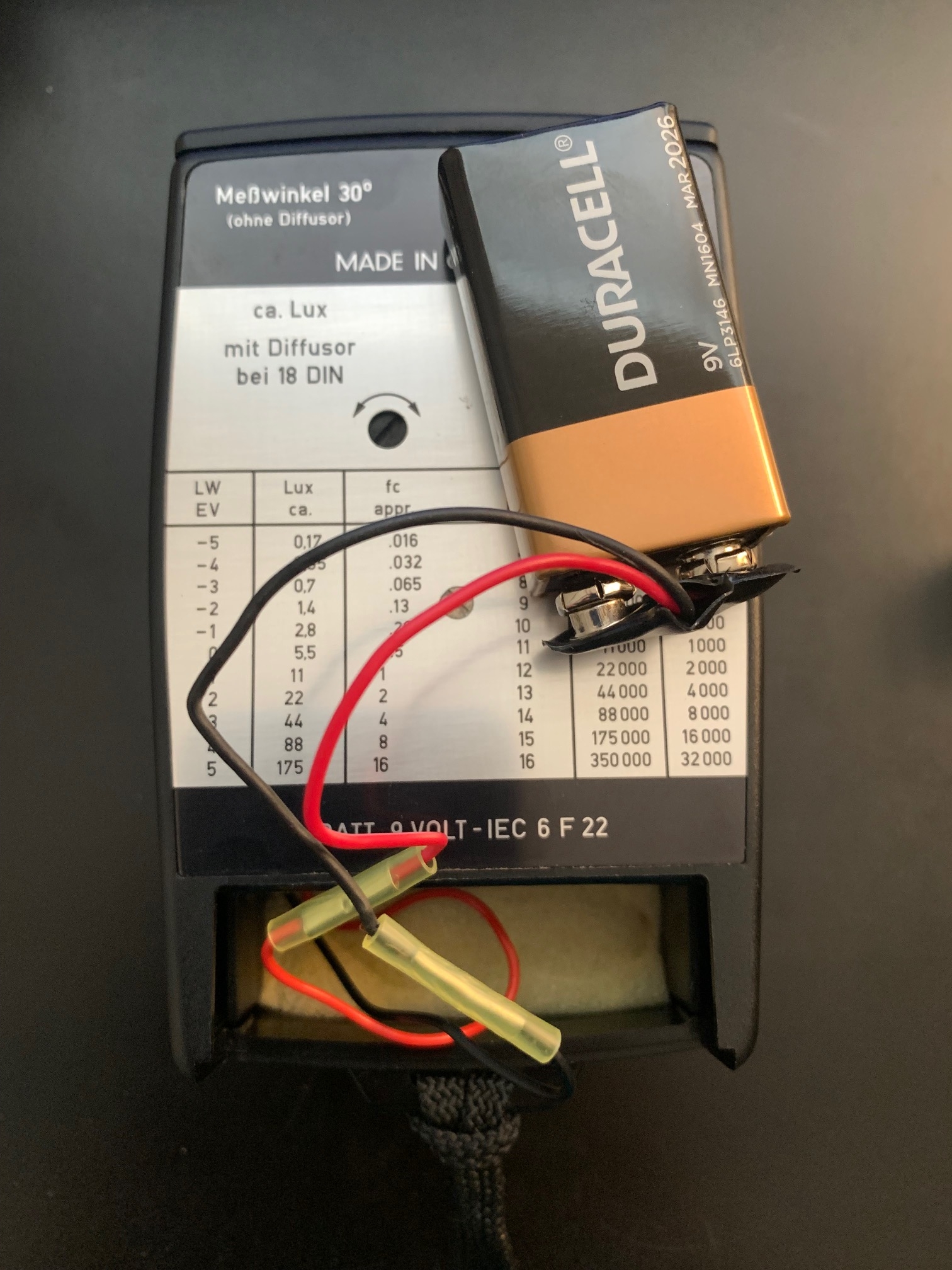

That seems a real challenge because the battery compartment is so "efficient". The battery connector on mine was repaired before my aquisition with too long of a tail and some sort of wire connectors so it's a real PIA to replace batteries. Too short and it might become a PIA to change batteries. I'd love to know how long the factory spec'd that...
I'd post a picture of the "wrong way to fix that problem" but then I'd have to fiddle a lot to get the battery back in so the door attaches properly, and I'm not in a patient mood at the moment. I know I'd end up curing and blowing my stack. :smile:

I'll try to retrieve my Profisix F to see how long the leads are.
Thanks, Matt. I'd apreciate that knowledge. I think part of my problem are the wire connectors. As fate would have it, I took a picture to show you and then ended up fussing with it and couldn't get the battery back in... and then had the insight to remove the foam pad that is in the bottom of the battery compartment. Much easier, yet it might be even easier with the correct length leads.

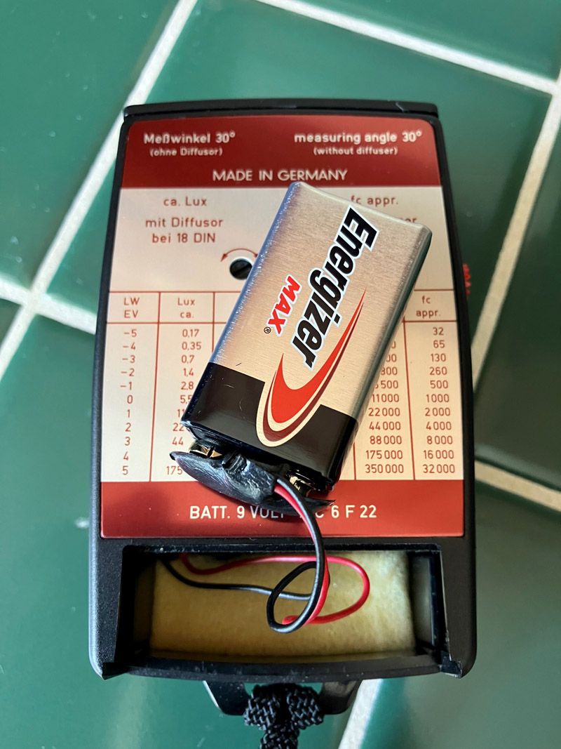

Brian - those wire connectors seem to be a repair choice of convenience. A bit of heat shrink tubing and a spot of solder to connect the leads would have taken some time and care, but ultimately a better solution. Here's my SBC for reference. I don't use it very often now but it still does everything I require when I do.
