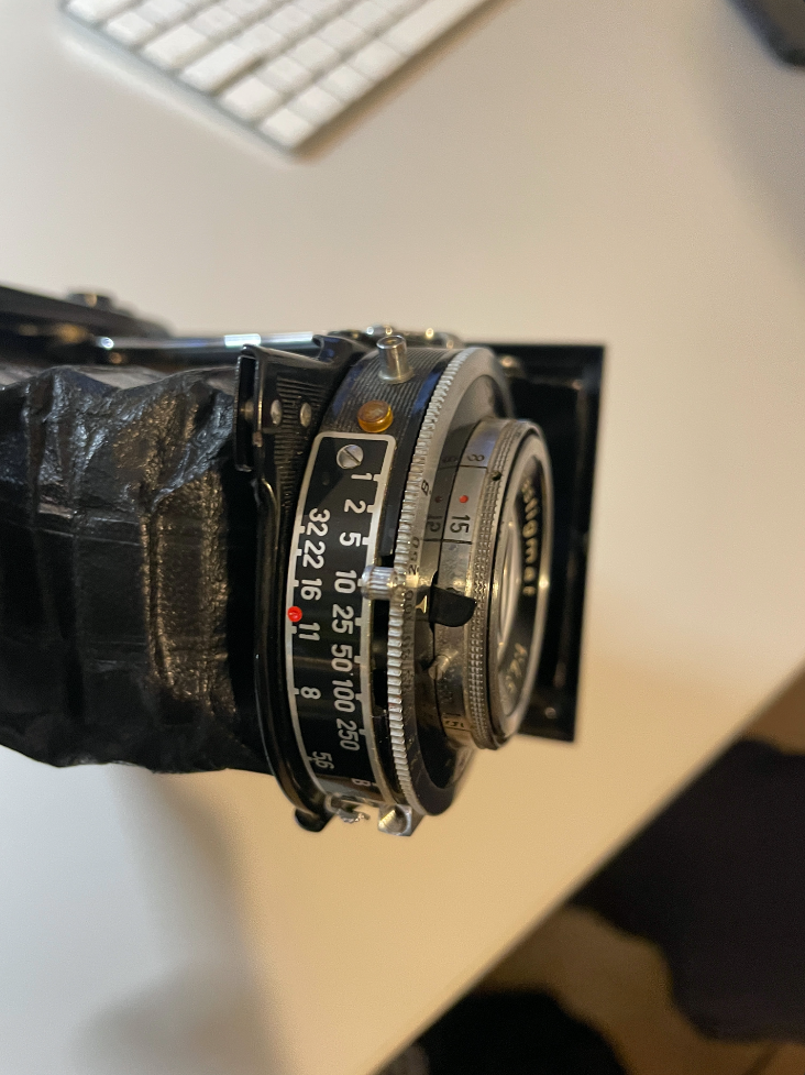

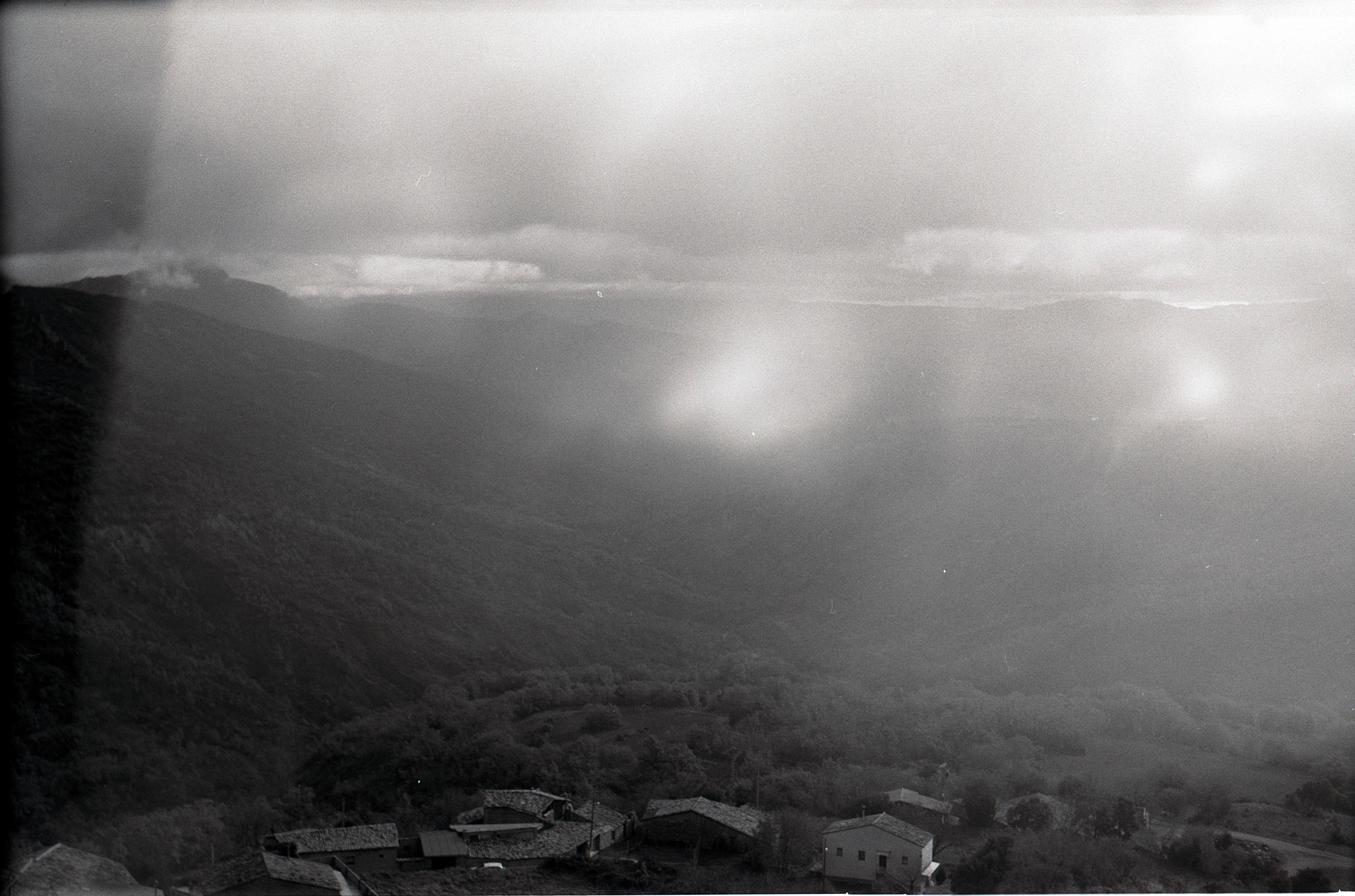

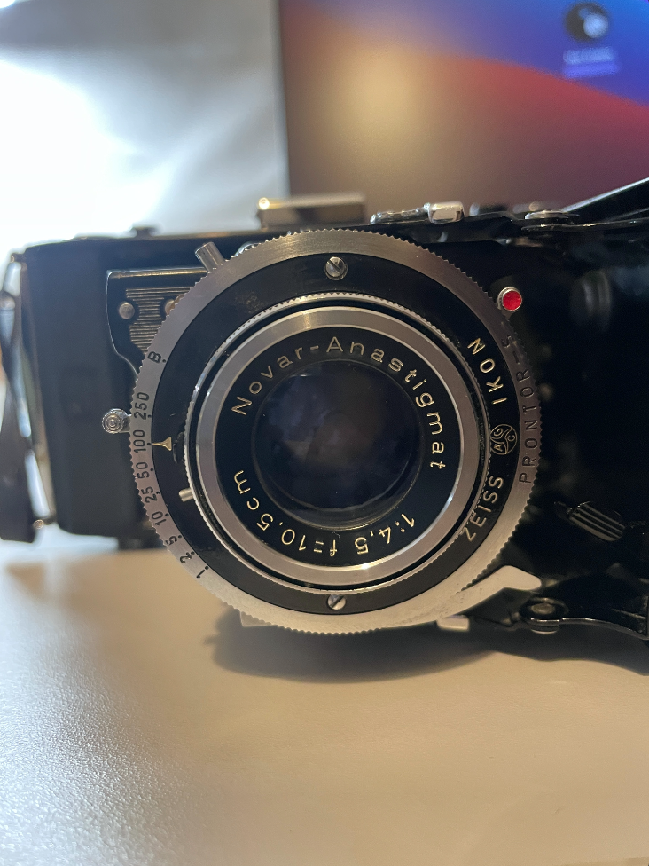

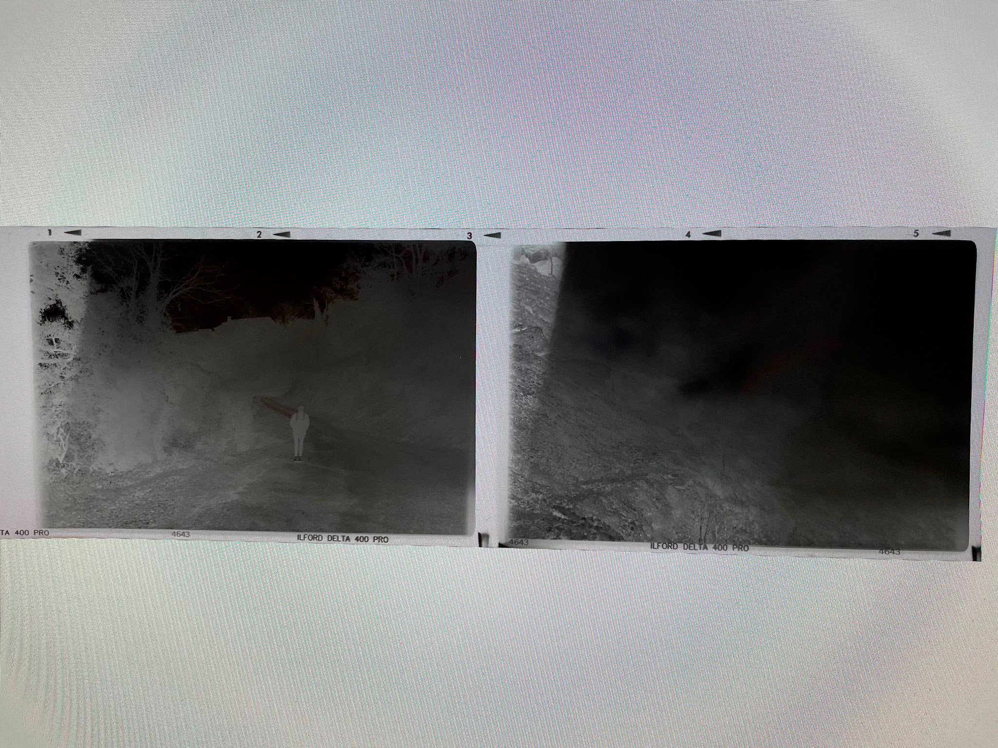

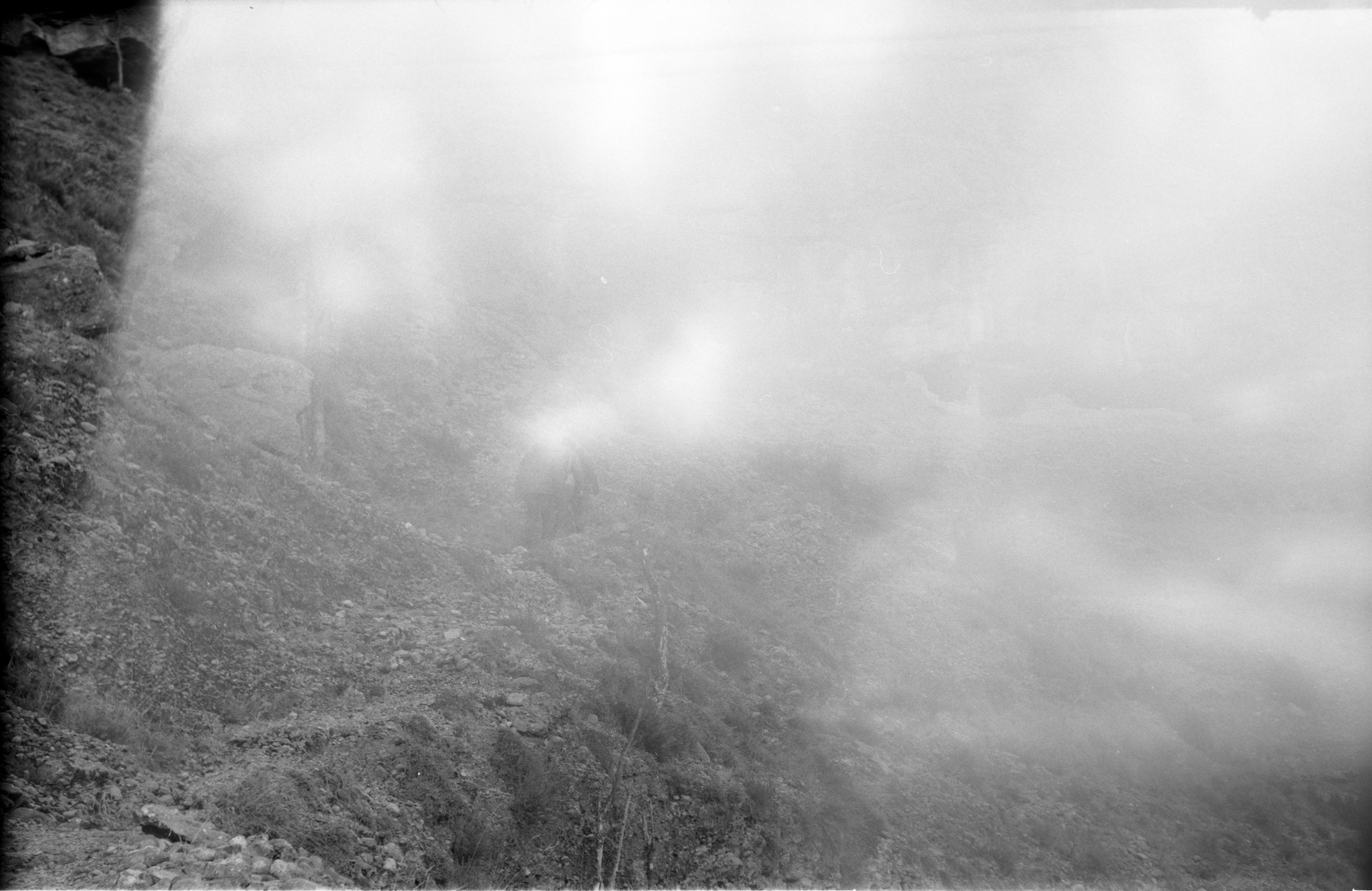

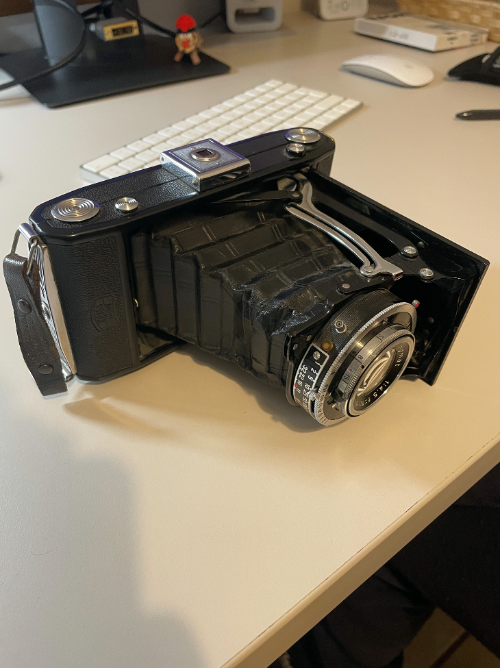

Hello everyone!
Recently I shot one roll of 120 film on a camera I found at a jumble sale. The camera is the "Zeiss Ikon Nettar 515/2".
All the 8 photos have the same light leak. I don't think it is from the bellows because you only can see it within the frame.
Here you have some scans, photos of the camera and the negatives.
Any idea of what happens?
Thanks!!

Bellows.
Since the bellows are in front of the framing mask, the rest of the film is protected. It is leaks from the back that go everywhere.
Place the negative back in the camera as it was shot. This will show you the area to focus your search on. Looks to me like a light leak from 'upper right' of the negatives you show. The area without a leak is probably shaded by some internal part, maybe another bellows fold.

Yes, I would suspect the area of the bellows that attaches to the front standard, as they appear a bit rumpled. However, light leaks come from the most surprising places!
That is a very fine camera and is worth the effort to chase down and repair the leaks. A bit of patience and careful repairs will give you a very capable camera!

Take the camera into noon day sun, point it at it (w/ the shutter closed), and put an eye into the film chamber to see where the leaks are at. You can take your free hand and move it around the bellows and lens to make sure you know where the leak(s) is. That is one huge light leak you got there, shouldn't be hard to find it, but it could be coming from multiple places.
Or, bring the camera and a flashlight into a dark closet, and if you shine the light into the film chamber and move it around you should see the leaks light up like a Christmas tree.

Honestly, a light leak that bad should show up easily-- put the camera on a tripod, open the back, extend the front, and shine a bright flashlight around the bellows, especially where it attaches at each end. Daylight, night time, closet, back yard-- this should show up obviously. I'd guess the bellows has separated from the frame somewhere, but that's a guess.

I have tried several means of finding light leaks in cameras and a bright light inside the bellows in total darkness is the best. Anything other than black is a leak.
Golden Heavy Body Artist Paint #1040 Carbon Black diluted no more than 1:1 painted on the inside of the bellows in thin layers works extremely well. The paint remains flexible when dry and does not flake off.
https://www.goldenpaints.com/products/colors/heavy-body Perhaps a similar artist paint is available in your area.
Black rip stop nylon bonded with flexible fabric glue will patch holes/tears the cost with the paint.
To check the back for leaks set the aperture to f4.5, lock the shutter open on B, then in total darkness shine a bright light in through the lens while observing the camera's back edges.
