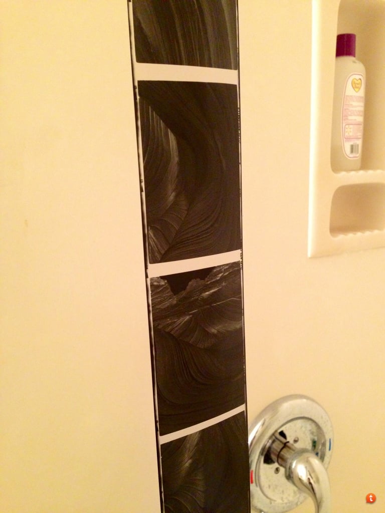

I'm encountering a really really weird situation right now. I have an old Franka Rolfix 6x9 folding camera. It's in great cosmetic and mechanical condition. Few weeks ago, I shot a roll of HP5 400 pulled to 200 and after I developed it, there were light leaks along the edges of the film. I have posted about this. Details here: (there was a url link here which no longer exists)
I went on a trip to The Wave, Vermillion Cliffs few days ago and shot 2 rolls of RVP50 and 1 roll of Ilford FP4 125. **BOTH ROLLS WERE LOADED AND SHOT IN SIMILAR LIGHTING CONDITION (Bright outdoor, loading the camera with my back facing the sun, so film was loaded in my shadow). And here's the weird part, the color film (RVP50) came out perfect with no light leaks at all. But the FP4 125 came out like last time, with light leaks along the top and bottom edge of the film. Color film was processed professionally at my local lab. B&W film processed myself (both times, HP5 400 and FP4 125). I can assure you that this is not a procedural issue. I have developed hundreds of rolls of film and never screwed up one (yes, not even the first time.. well.. except a few times where I didn't think I got any good photos and just threw away the film).
So can anyone explain this to me? Light leaks on B&W film but not on the color one?
P.S. both film were purchased from the same place (B&H) at the same time. New film. Unopened.

Here's a photo.

you dont show us the leaked film -- is the light leak inside the picture frame area, or outside it? is the light leaking around the film spool flange, or through the bellows?
WOOPS -- ok, you do show us.
that is light leaking around the film flange after you take the film out of the camera. Keep the film in a dim place, make sure it is wound tightly on the spool -- some types of film are stiffer than others and don't wind as tightly.
leak is not the camera. it is the film flange. As long as the fogged area doesn't reach the image area, no big deal.

the colour was developed at a lab, the b/w at home. So something in the home developing would be by far the most likely answer. Not a procedural issue but a leak somewhere. Crack in the developing tank or tank top? A leak in your film changing tent?

I think it is a problem with how you are handling the film once it is exposed. As backing paper, spools and sealing tapes differ between types of film, it may be that your technique with the colour films doesn't result in problems, whereas with black and white films and that camera they do.

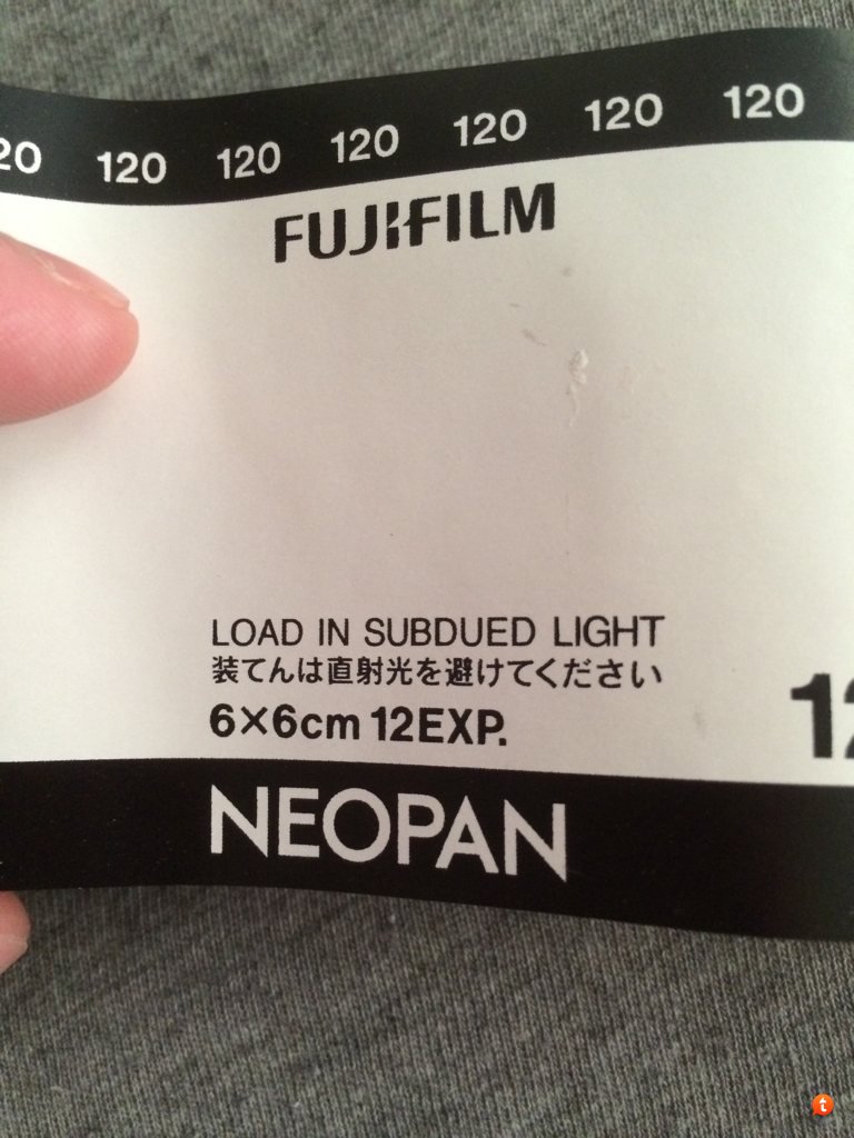

Here's a photo.
Typical results from loading 120 rollfilm in daylight, or letting the rolls sit around in the light. Light leaks between the paper and the spool.
It is your own experiment in the desert. Not quite "subdued light" :smile:
ziyanglai

I do not think film type has anything to do with it. The reason you are seeing it on the B&W and not the color is the film speed.
ISO 125 is 1 1/3 stops more sensitive to light than ISO 50.
ISO 400 is 1 2/3 stops more sensitive to light than ISO 125 and 3 stops more sensitive to light than ISO 50.

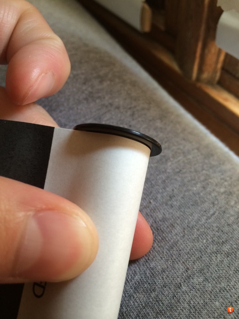

As others have asked How tightly is the exposed film wound as you take it out of the camera? If you put the ends of the spool between your thumb and index finger holding it tight enough to prevent the spool from turning and pull on the loose end of the backing paper how far will it pull out before becoming too tight to move and further?
I routinely use ISO 400 B&W film to test cameras for light leaks. The EI I expose it at has no relevance to any light leak that may be present and many that are very noticeable on ISO 400 film are barely detectable on ISO 100 film.
As others indicated it is a film/spool flange issue.

I most certainly appears to be spool flange light leak. There is a reason that film companies warn to handle in subdued light. Care must be taken when loading and unloading older folding cameras that the film stays tightly wound on the spool, and maintains that after unloading until placed on developing reels.

yes those posts were made as I was typing my reply but I do agree with them that the most likely cause is the film not being rolled super tightly onto the take up spool in the camera (and then being handled in bright-ish light). Turning your back in bright sunlight is still going to expose the film to more light than is recommended.

This certainly looks like light leaks around the spool flange. The older folders were not always good at keeping tension on the take-up spool. After unloading the spool you should try tensioning the paper before taping the spool. I also keep the films in a dark container after unloading.
The films can be differently affected as they can wind with different tensions (e.g. due to different backing paper thickness or drag) and also while the spool and paper width should be standardised, I have had issues when changing brands of film with some combinations having gaps between paper and spool, and others where the paper is wider than the spool flange spacing.

Ok so I have shot another roll loaded indoors and had it professionally developed. Still light leaks on the top and bottom edges. So it seems like it's a film spool issue. Is there anything that I can do about this? Sometimes it does cuts into the frame a little bit, but the light leaks are just annoying to me.

Spools tend to be SLIGHTLY different distance apart from manufacture to manufacturer, if you shoot some kodak, and follow it with ilford, the take up spool will have a different width than the original, couple this with not shielding the roll from the sun, and you'll get some light leak at the edges.
I think the problem is how carefully you are shielding the film once it is shot. Which seems not very well, considering how much leak there is. There's a reason the spools say they should only be loaded and unloaded in subdued light.
