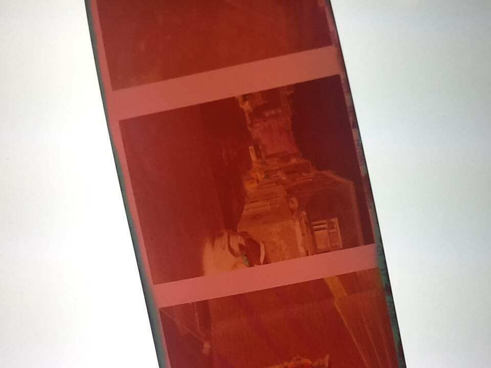

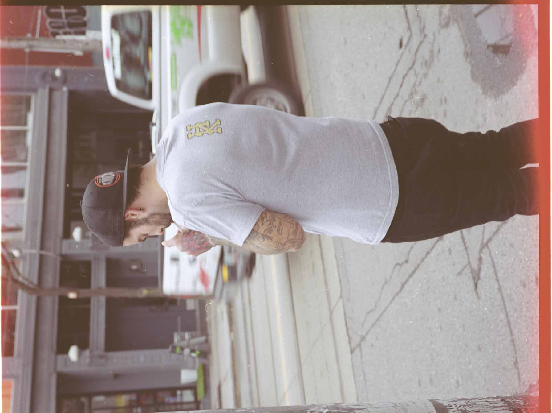

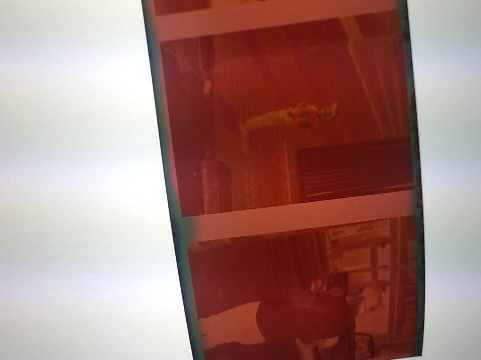

Hi guys, help me with identifying the bottom part of these images. Are they light leaks? thanks in advance.

It could be a light leak but I suspect there was not enough chemistry to cover the film. Would you please post the negatives.

And not seeing the negatives it is even harder.
Just pick a sheet of paper, put strip of negative with defects over it and put them against a window. Pick some digi device and take a pic.

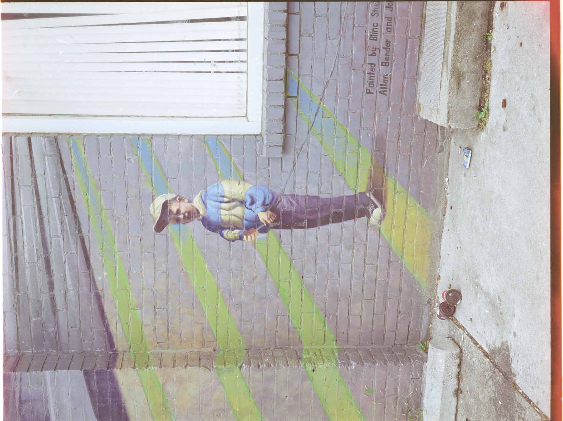

don't think it is because its not uniform on all shots. Im using a Fuji Gs645 i.e. has a bellows.

The good news is it may be 'you' let the film paper slacken off and you were not in the shade.
The paper needs to be taught,
You need to be in a shop door way or under a leafy tree.
Jim Jones
Jan 16, 2006
3,740
Chillicothe MO
Xmas nailed it. Roll film should be handled in the shade, especially when removing it from the camera. Slack should be removed from the backing paper, but don't clinch it too tightly. Store the film in a fairly light-tight container until processed.
