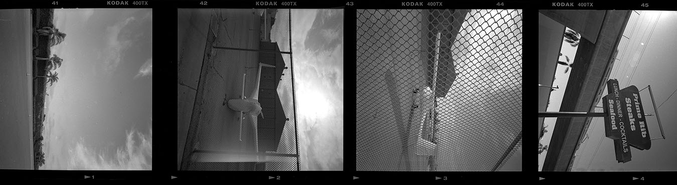

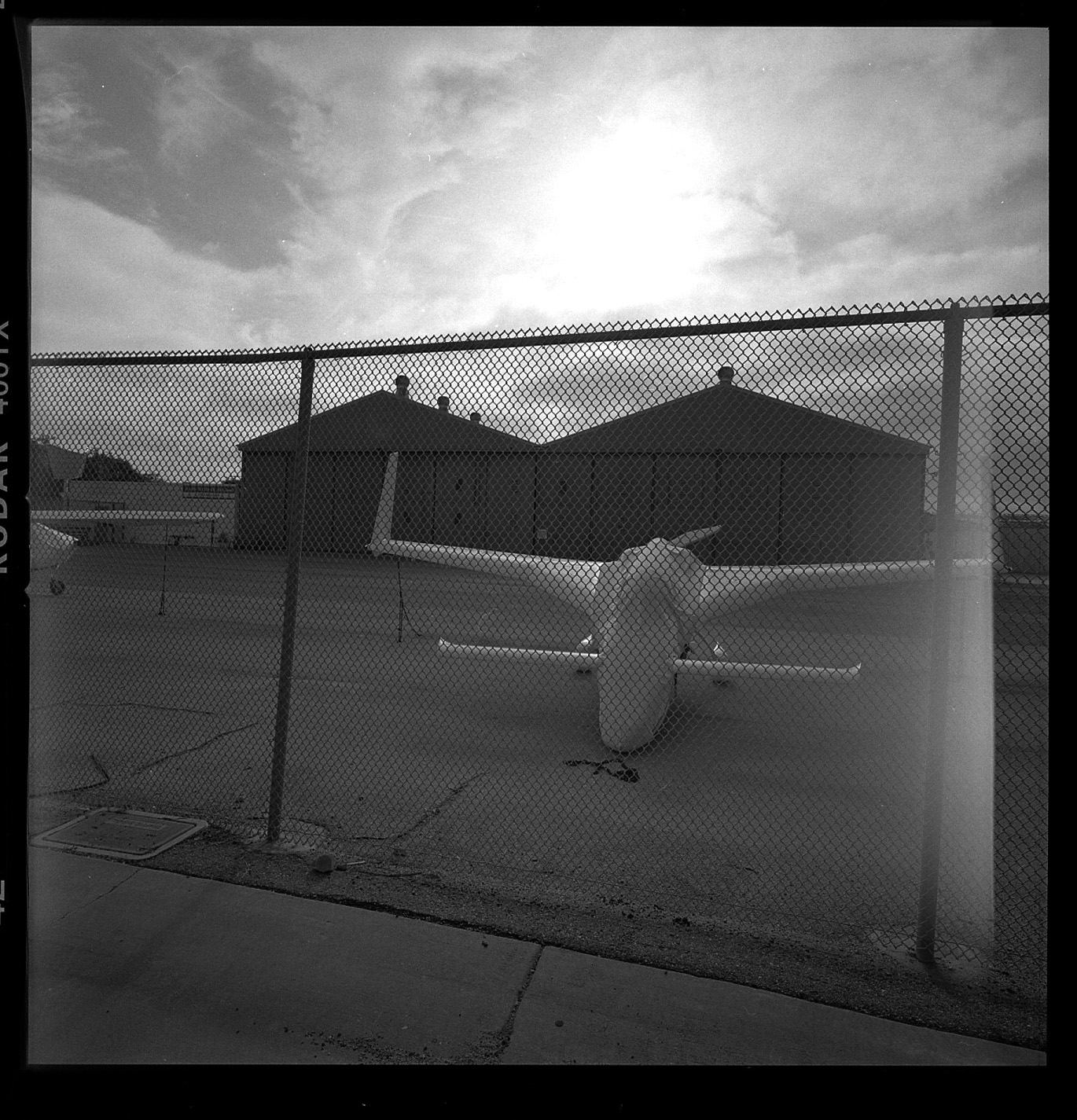

I have what looks like a light leak showing up on only one frame from a roll how with a Hasselblad 500 SWC. It is the second frame on the roll and the only one like this, and even seems to be on both sides, unless the other is a developing issue. Other frames shot in the same lighting conditions are fine.

That is the film back light seal leak, which appears on the right side of the negative and print.

Which frame was it on? If it's on the first it might have leaked as you pulled the dark slide. Then the seal might have had time to relax from it's compressed state and fill the light leak gap. If you left the dark slide out for the rest of the roll it would only show on one frame. Also, if it's a tiny little leak and the camera was left idle over an extended period that tiny little leak will have much more time to strike the film. If the other shots were more rapid it's possible that teeny-tiny little leak might not have had enough time to work on the film. Just a thought?

It is on frame 2. There probably was not more than 15 minutes between shooting frame 1, 2 and 3. As a matter of fact, probably only a minute between 2 and 3. I usually put the dark slide back in the camera when the camera either goes back in the bag or I will be carrying it for a bit as a safeguard against accidentally tripping the shutter. I know there is a lock on the shutter release button, but the dark slide is more convenient. The slide was in and out of the camera probably 4 times for this roll. But I do think the seal is on its way out, I'll need to replace it ASAP.

That leak is on the left side of the film as it would have sat in the camera, and it's partially shadowed. The source of the light must be on the left, in a location where the film gate casts a shadow. The sun (behind clouds) is in frame, so it can't be a reflection of the sun shining on the inside of the mirror box. A dark slide leak ought to affect the rebate, not cast a shadow into the frame like that. I think that's a leak between the film back and the camera body.

Why would it only appear on one frame of the roll?
Did you change backs at some point while frame 2 was on the front side of the magazine?

Why would it only appear on one frame of the roll? Is it a sign the seal is gradually going, only leaking sometimes?
Because the darkslide slot happened to be turned toward the sun while the film was at that part of the roll. I have had this happen on several film backs and it drove me nuts until I figured out that fogging on the right side means a light leak on the left. Save yourself grief and replace the light seal on that film back.

I have had intermittent dark slide leaks before - it is usually caused by the degrading foam getting pulled out with the slide, causing the metal seal to be propped open a bit. The next time I stick the slide in, it pushes the foam back in, and does not interfere on the next image.
It looks like a classic dark slide seal issue. When the back is loose, the leak is usually at the bottom of the image.
