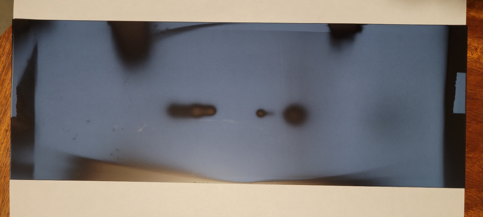

Thanks, both, for your inputs. Your comments gave me ideas on how to test this out. The short of it is there are light leaks. I had tried to seal it up using gaffers tape to seal obvious leaks. I missed a bunch.

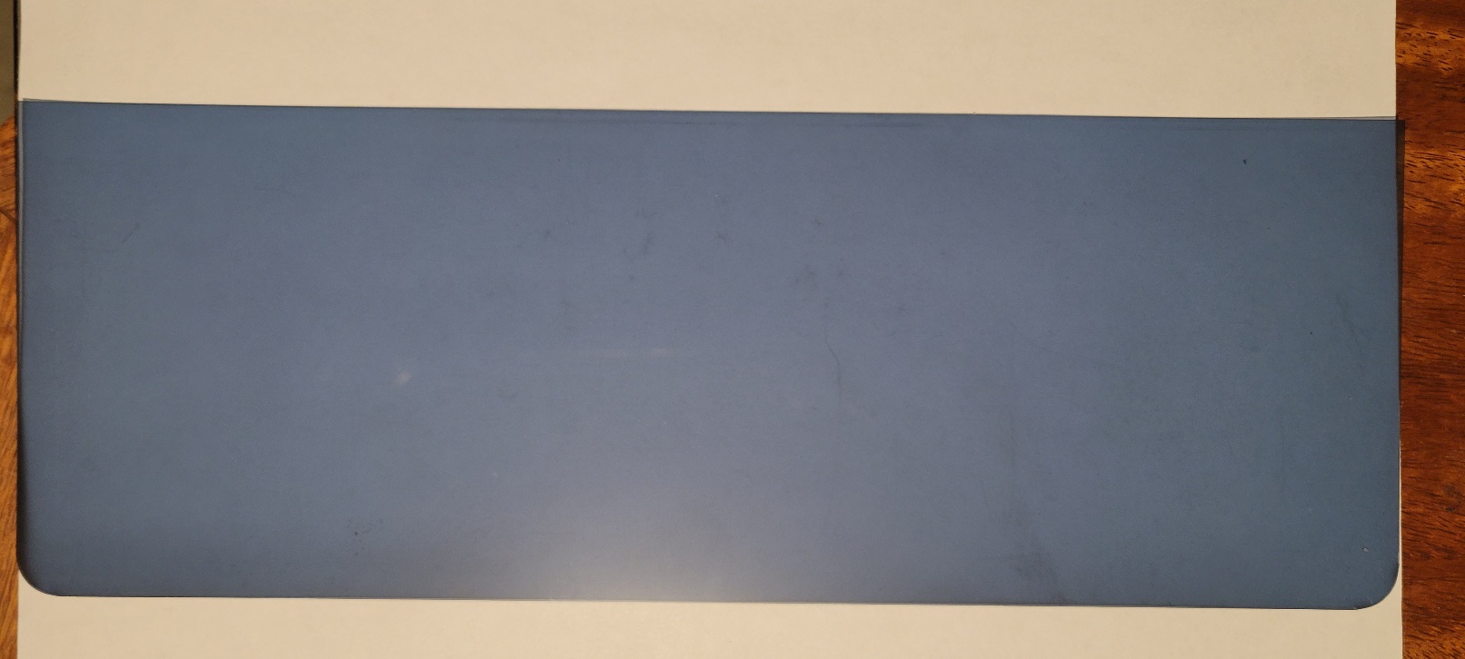

I'm using x-ray film cut down to size, so I cut one sheet into three pieces. The first I processed without exposing in any way. This was to ensure the film itself hadn't been compromised. It came out clear, as shown.
I put the second sheet into the camera and brought it outside into direct sunlight. I moved the camera around quite liberally including with the lens cover down. The result shows significant light leaks.

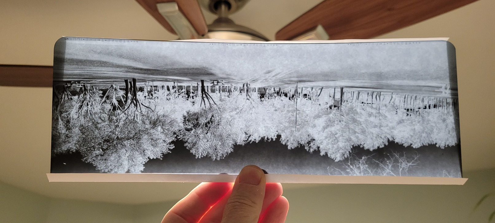

So, to rule out anything mechanical, I loaded the third sheet and used a whole bunch of gaffers tape to seal up the edges and any other seams I thought had already been filled due to leaks. Result is a pretty good negative.
So the lines in the previous post are definitely due to light leaks, and probably some reflections inside -- need to get some flat black paint to take care of that part.
