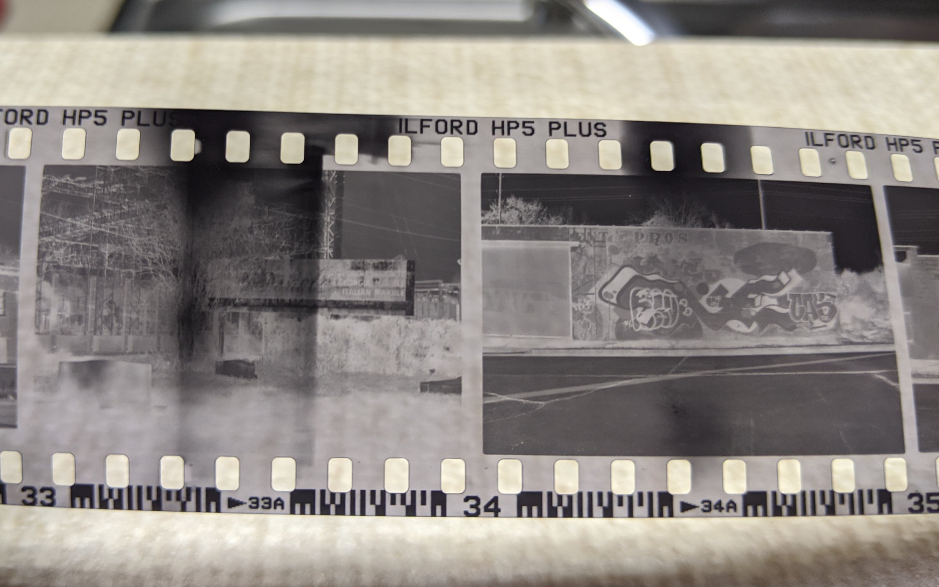

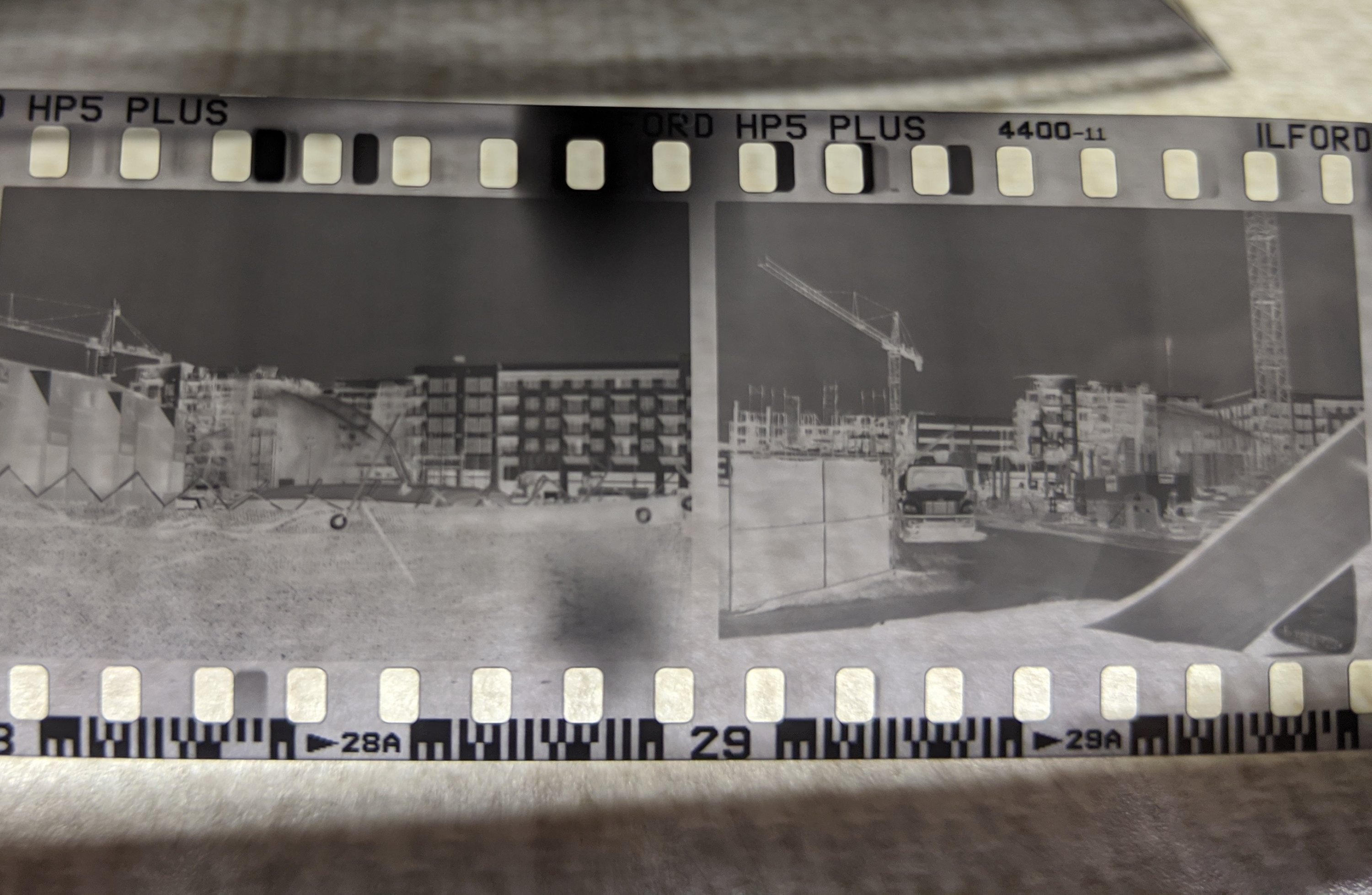

Recently had a few rolls (HP5+, TriX, and Double X) that are all exhibiting the same issues. Only towards the last 10 frames of the roll.
Dark patches on the negatives. Lighter areas along the middle of the frame.
Not sure if this is a camera light leak, a Paterson Tank light leak, or a processing error.
Photos of the negatives attached.
Thanks for all the help.

In one scan you seem to have images of sprocket holes (dark areas of the same shape) between actual sprocket holes, with fairly sharp edges - and it lines up with the fogged part of the image. I'm going to guess that suggests fogging while the film was rolled up - like on the take-up spool in the camera.
Check the back of the camera and see if the light seals are intact.
When I had a similar experience, it was only when I had the camera case off - the case had covered the camera back. In addition to having the case off, i had a longer delay between taking pictures, allowing enough light through a space between the camera back and the body where the light seal had degraded.

That is clearly a light leak near to the take-up spool. Unprocessed film is rather opaque and the effect of a light leak here depends entirely on the time between shots. Less than a minute between shots probably does not allow enough light to penetrate the film to have a noticeable effect. A couple of hours between shots will produce a more noticeable effect and a few days between shots will produce a very noticeable effect. This will account for the intermittent appearance of the leak.

It could be that the light leak is tiny and is only affecting the film when sunlight falls on the camera back. You could try putting some processed negatives in the camera and seeing if the fogging lines up with any openings that should be light tight. Foam seals can look good while still letting in tiny amounts of light.
As Peltigera says, if you wind on several shots in fast succession you may notice nothing whereas if you take a shot then leave the camera even in dull light for a few days that could be sufficient to fog a frame, while leaving adjacent frames perfectly fine.
