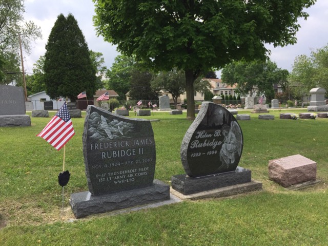

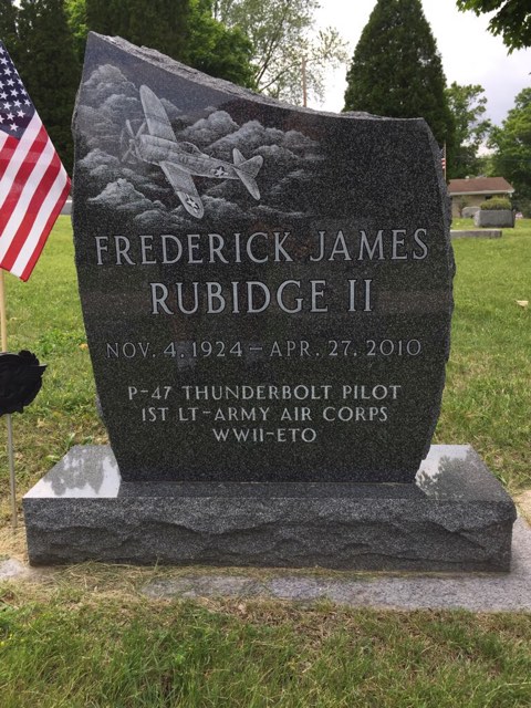

I just went back out there and shot a bunch of photos.
The only thing on the stone is the airplane. No faces. No black blobs. I will have to develop the film.
I shot some photos with the Agfa and my Hasselblad. I also made some Digital and HDR shots. ImageUploadedByTapatalk1433539326.457160.jpg ImageUploadedByTapatalk1433539353.968752.jpg

Then I go for the ghosts. Or watersoluble paint.
