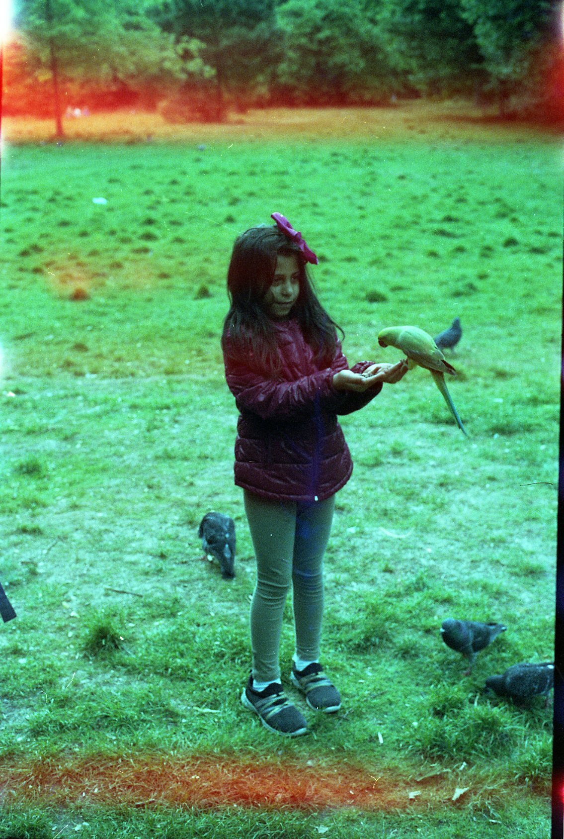

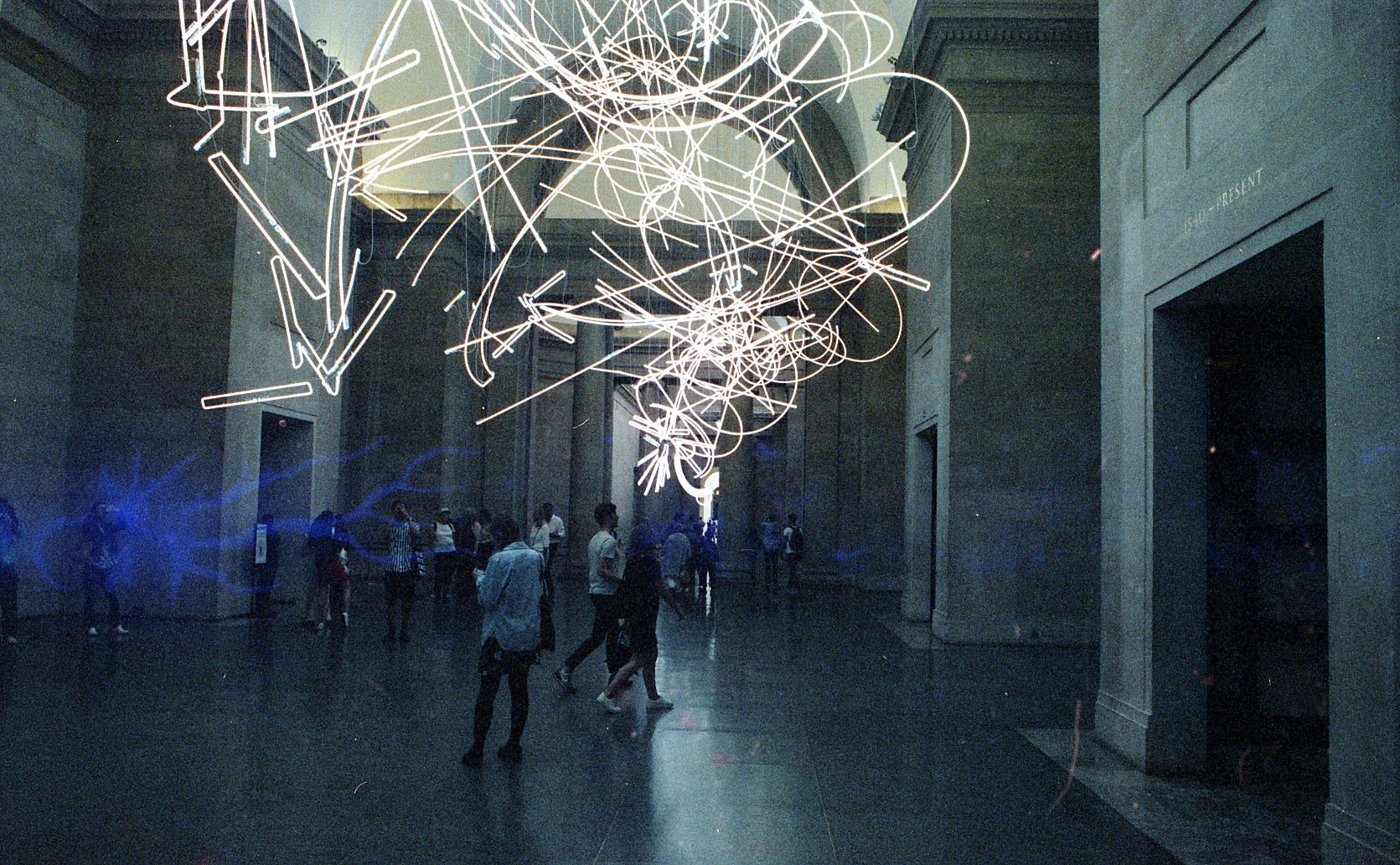

Usually I do not use any color negative film, but reading about Cinestill800 made me curious, so I decided to try a roll on a short trip to London. Most of the film came out fine, also by dayligh (the deer)t, but a few negatives showed something that looked like a light leak (at the end of the film) and a few some strange blue kind of lightningish effect (at the beginning of the film).
I'm almost sure it was not the camera, as I used it for b/w film before and after this film. Could it be something during development, the x-rays while checking in and out the Eurostar, or something else?
I just did a quick scan of the negatives, so there is some dust annd quality is not so good, but good enough to see what I mean.

Surely people more experience than I will chime in, so don't take my word too seriously, as I may be wrong.
The red to me looks like a light leak.

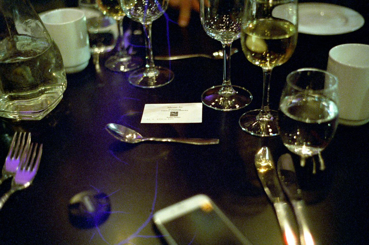

The blue looks like it could be artifacts from static electricity, but it also almost seems like a drop of liquid (developer, perhaps) that started to spread down.

Frank 53 - hello again:D......
Well - Frank a light leak to every emulsion
isn't very hard to identify.E6,C41,bw.
You will have the same structure of damage to some frames becomming less
and more less to the rest of frames.
Or it goes in the oposite direction (to become more and more) - of cause.
Is that the case what happened.
From your scan it is 100% a light leak
or it is 100% a instagram filter.:D:cool:

I've seen the blue light flash on Cinestill 800 as well, I think it is related to the cleaning/processing of ECN2 to a more c-41 friendly environment. (removal of remjet).

Thank you for your replies. So it could be something in the proces, of removing the remjet or the development.
I have one more roll of this film so I will use that soon and have it developed. I'll see how it comes back.
To be sure, I will load and unload the camera in the dark.
About the camera, it seems fine to me, use it a lot with fp4+ and hp5+ on different iso's. Sealing was replaced a few months ago and no problems after that.

I forgot to mention that I process my own c-41, regular daylight tank, Tetenal c-41.
Blue lights are definitely something from before the film sits on the shelf in the store.
My guess; static discharge from high-speed rollers, post remjet removal.

Cinestill film is motion picture film that the Cinestill people buy in bulk, scrub the remjet off, and then cut and package in 135 (aka 35mm) cassettes for use in standard 35mm still cameras.
Remjet is really designed to be removed at time of development, not prior to exposure, so it doesn't surprise me that there would be some instances of unwanted effects in still pictures taken with it.

Those red bands look like a light leak through the felt light trap, or perhaps a little light piping since there is no more remjet and no anti-halation layer to stop it. Those are kinda important so they are put there for a reason....
