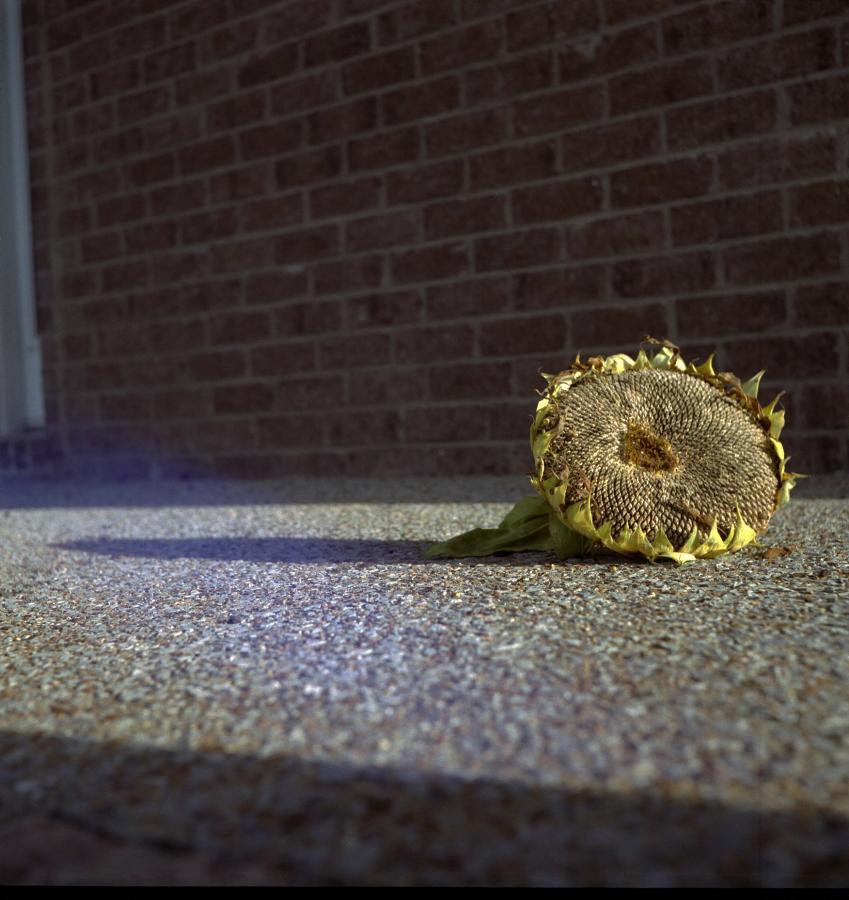

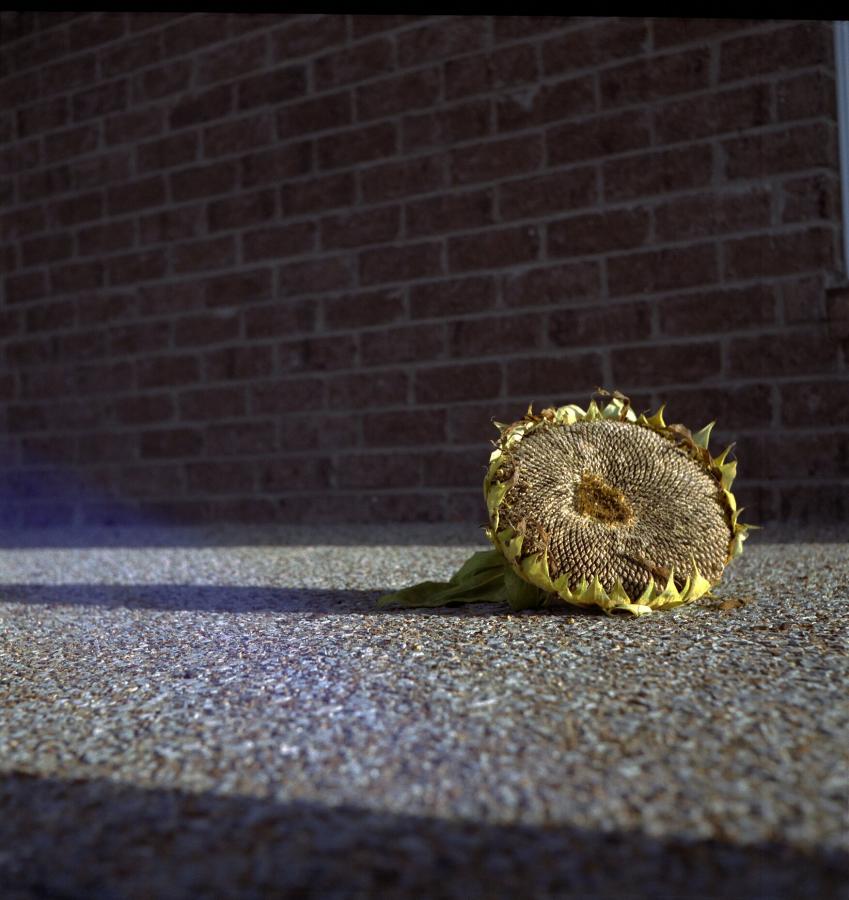

I have an Automat RF111a and I am currently, intermittently, getting some sort of light leak in the same place of the frame. I have tried different rolls of film, different labs (although unlikely the issue). I have also tried taping the sides of the back of the camera (although I don't see the fog creeping in from the sides of the frame. It happens wide open at F3.5 or F8 so aperture doesn't seem to be an issue. It happens at 1/250 and 1s so speed doesn't seem to be the issue.
Is this an issue with the shutter sticking or something?

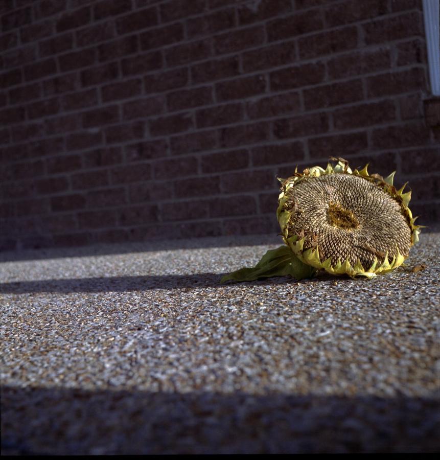

scan 0006 and 0007 attached show the issue, 0008 does not. I waited several minutes between shots to allow for any light leaks to expose itself.
Thanks in advance for your help.

The interior is still all black. It has recently (and for 1 and a half years) performed without a problem. The back seems to be fine and fits well.
Three rolls have been developed that exhibit the issue, two at one and one at the other. Both reputable and I have developed a lot with each of them. Plus, the spot, when it appears, is always in the same spot, so it would have to be something really odd to do it every so often in a perfect 6cm spot.
It also appears the back plate spring is still okay, so it should be putting pressure on the film and I believe it adds to the light-proofing of the door.
Again, thanks for the thoughts. I'm baffled.
