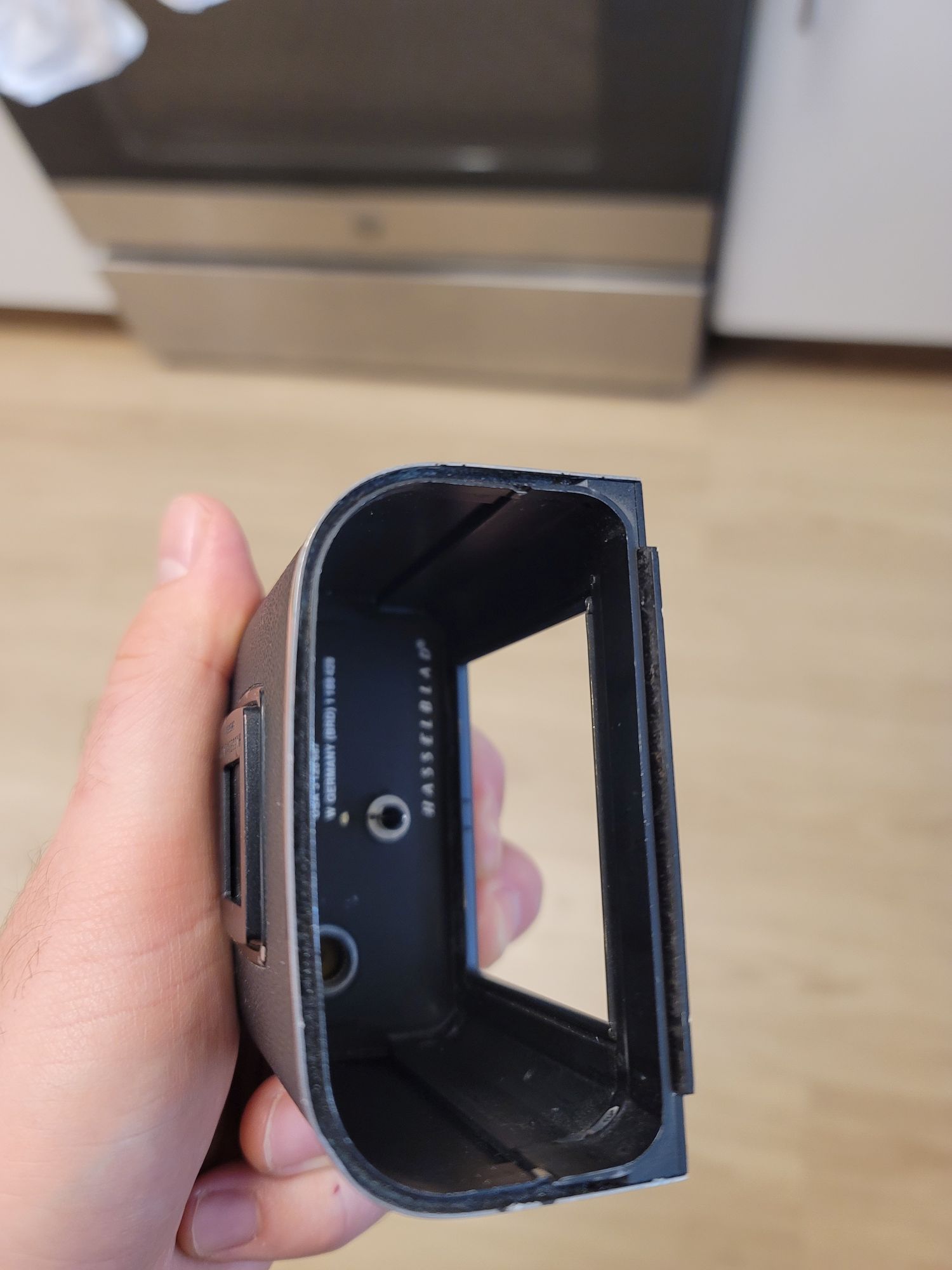

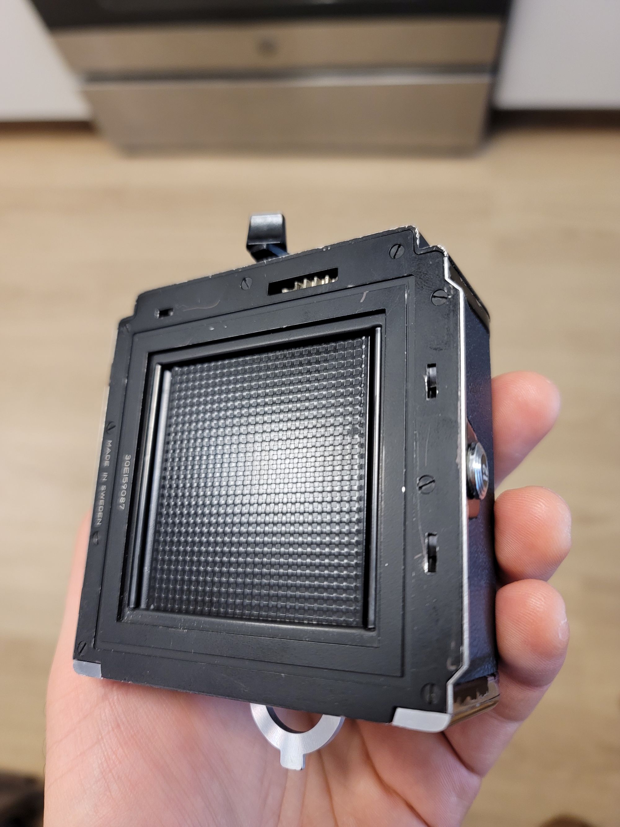

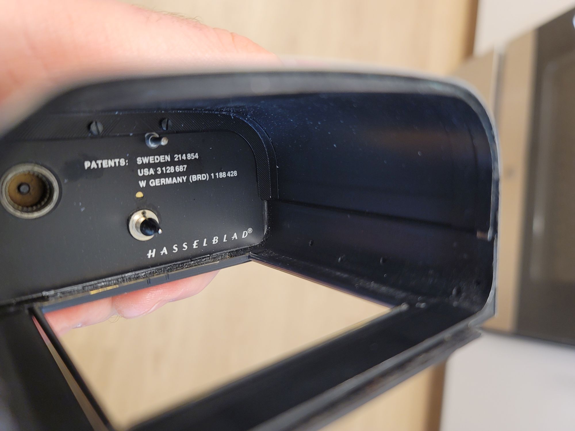

Hi Pieter!
I only got this camera half a year ago and have never changed the seals. Attaching the photos of one of my backs (the other one is currently loaded with film)

Hard to tell the state of the seals from photos. It is a simple fix, if you are so inclined there are repair kits available from Hasselblad or ebay and tutorials on YouTube. Or find a local tech. It is routine maintenance for Hasselblad film cameras.

this is likely a problem with the light seal of your back. the seal needs o be replaced by a Hasselblad technician. You'll need to run a roll through each back to find out which back is the culprit but, it won't hurt to have both serviced.
