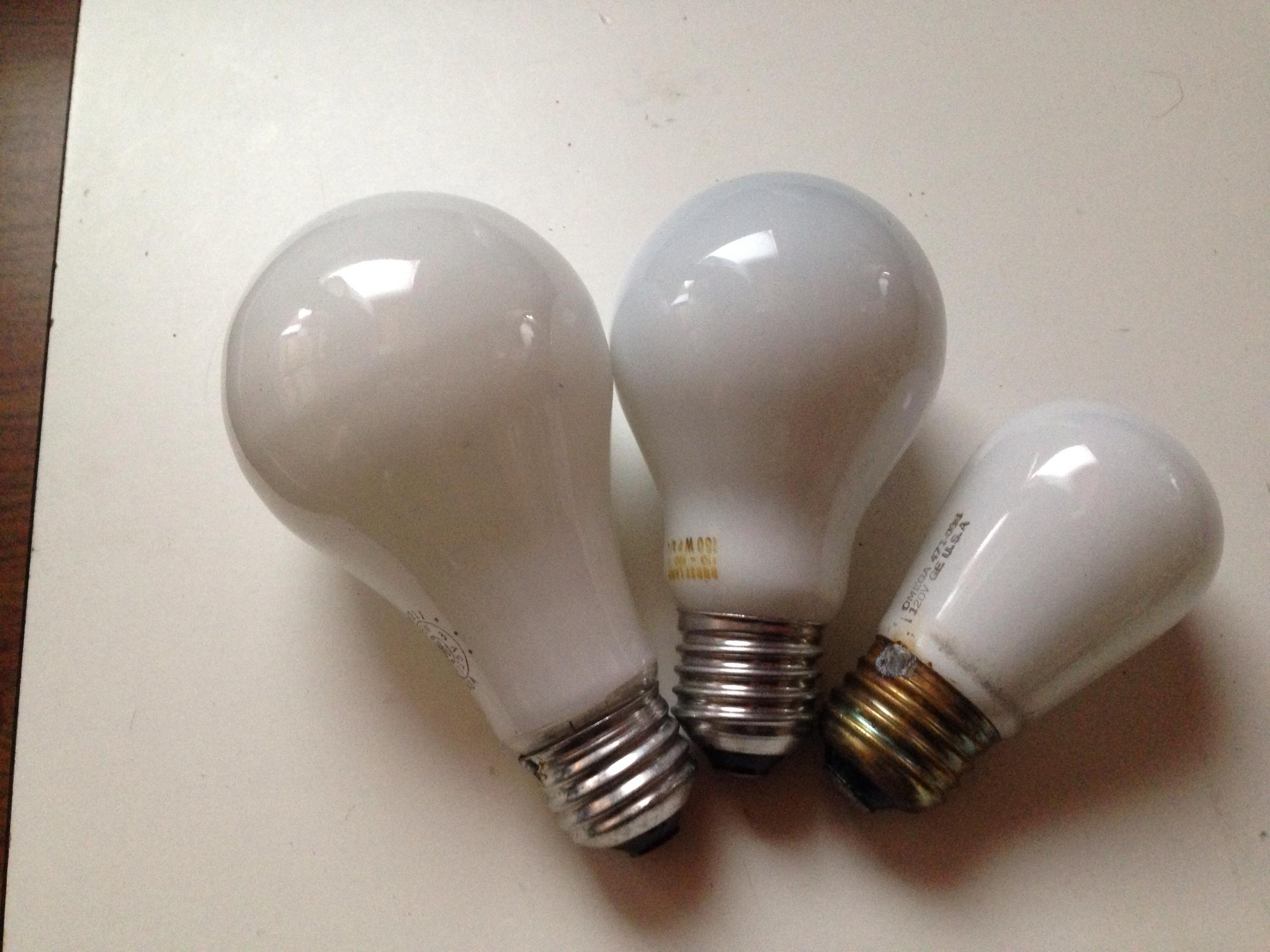

My Durst M805, bought used, came with a blown DURA150, the middle bulb above. On the left is a PH212, supposedly a good replacement for the DURA150 !
Aligning the light source is important, so will the PH212's larger size be able to mimic the performance of the smaller DURA150 ?

I googled for a moment and found this: For LURIOKIT BW condensor: 150W opal lamp (order code DULAMP 150) or - for short periods - 250W lamp (order code DULAMP 250)
About the larger PH212 bulb, the first question is if it will fit. If yes, you just install it. Bring the enlarger to about 40X50cm print height (16X20) and project on a white surface. Turn off all darkroom light and close the lens step by step while you do this. It will make it easier to see if you have even illumination. If you do not see problems, the next step is to make a print . . .
edit:
Sorry, I forgot to say first project without a negative ! This is also the reason for closing the lens, almost all the way . . . you see well uneven illumination then !

The larger size should give better coverage. It's when the bulb diameter is smaller that there usually an issue.

Regarding the ideal currently available bulbs for the M805, a semi-retired Durst serviceman recommended a PH140 over a PH211/PH212/213 shaped bulb. If in a push, I think the PH21X bulbs can be used but the bulb positioning shaft has to be lowered quite a bit.
