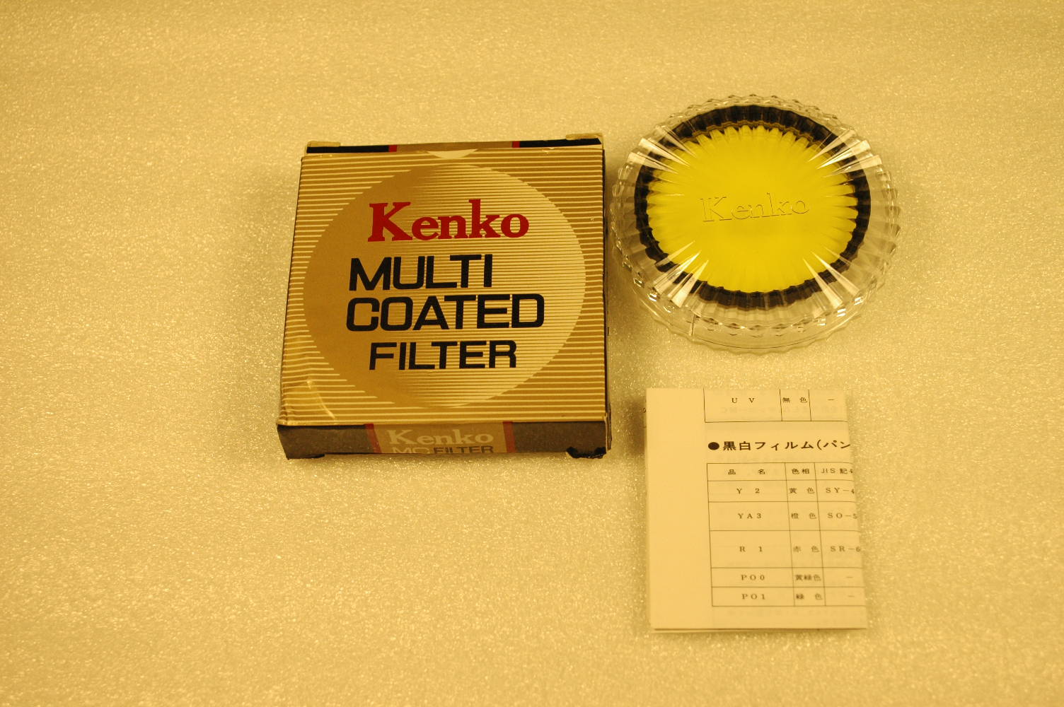

I just wanted to give it a try to see what happens. I used two regular spiral energy saving bulbs, not sure if they are daylight type. They are rated 13 watts, or 60w equivalent, not bright.
I put them on and shot 3 pictures on white background. The digital photos look awful. They look like yellow color.
Would the photo spiral bulbs be different? What is wrong with the regular home spiral bulbs, different temperature? Any filter can I use?
I was going to order some photo daylight bulbs. But I do not want this to happen....
I have a Nikon D70 and D200, they are on auto white balance.

Unless specifically marked as "daylight", household Compact Fluorescent Light (CFL) bulbs (spiral energy saving bulbs) are roughly the same colour temperature as regular tungsten light bulbs ~ 2800K. So set your camera's white balance to tungsten, fluorescent or auto. Judging from the attached picture, your camera was set to daylight, not auto white balance.
If you're shooting colour film with your current CFL bulbs, use a tungsten film or a blue filter with daylight film. Or get daylight CFL bulbs. They're available at the bigger hardware stores.
