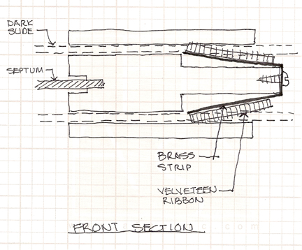

Lukas - I'm with Ole on this one. I used light weight brass with velvet ribbon from the fabric store. Here is the detail that I used and it seems to work just fine.
Waht type of brass? i.e. thickness etc.
