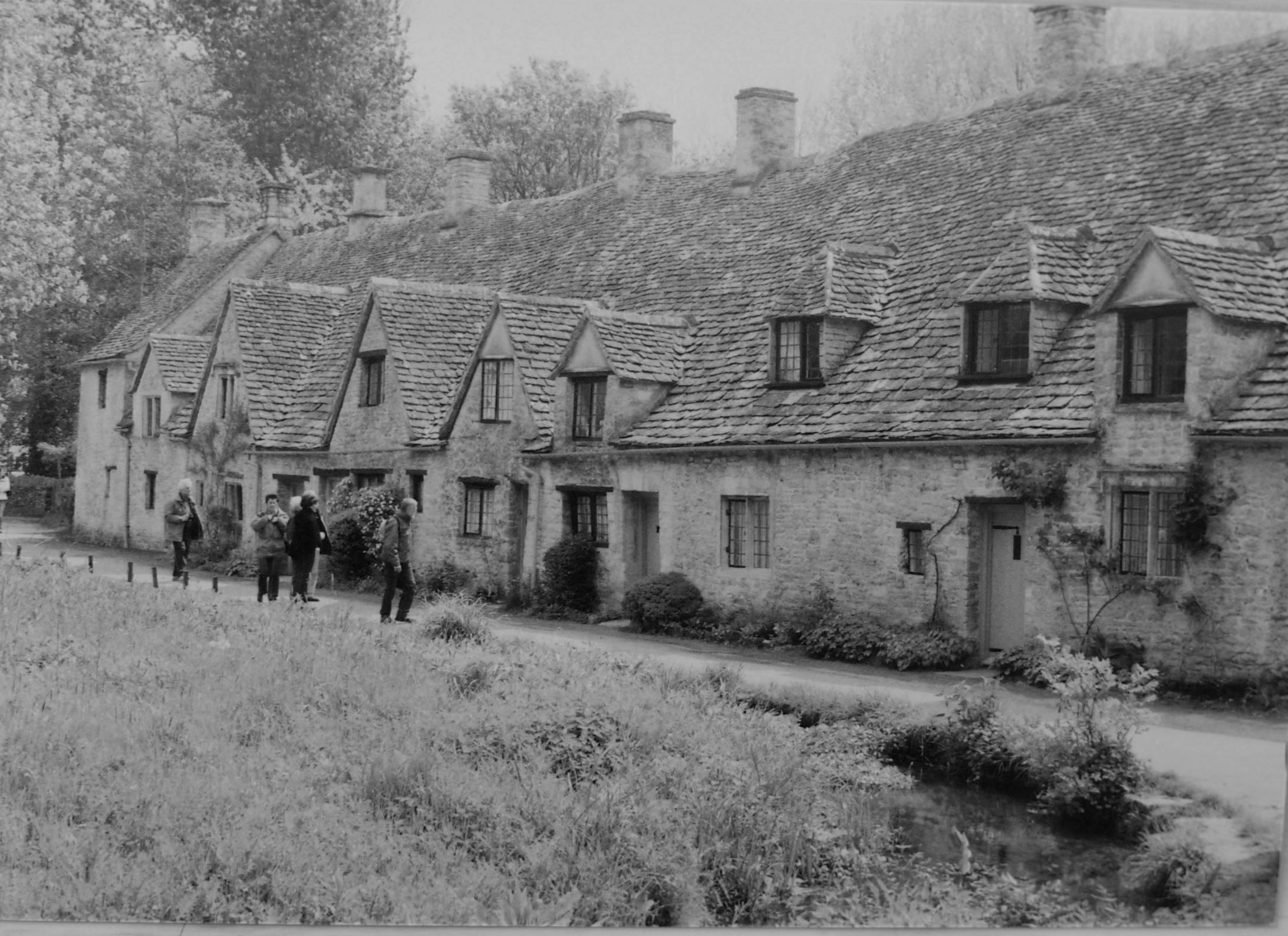

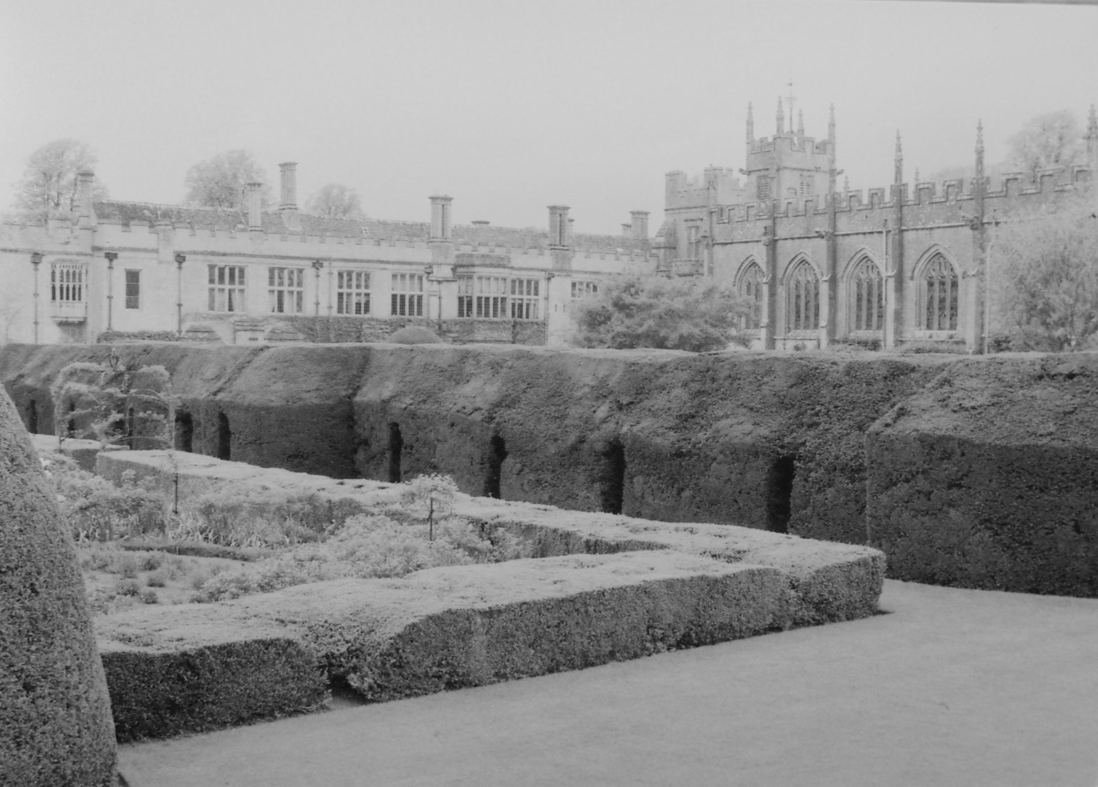

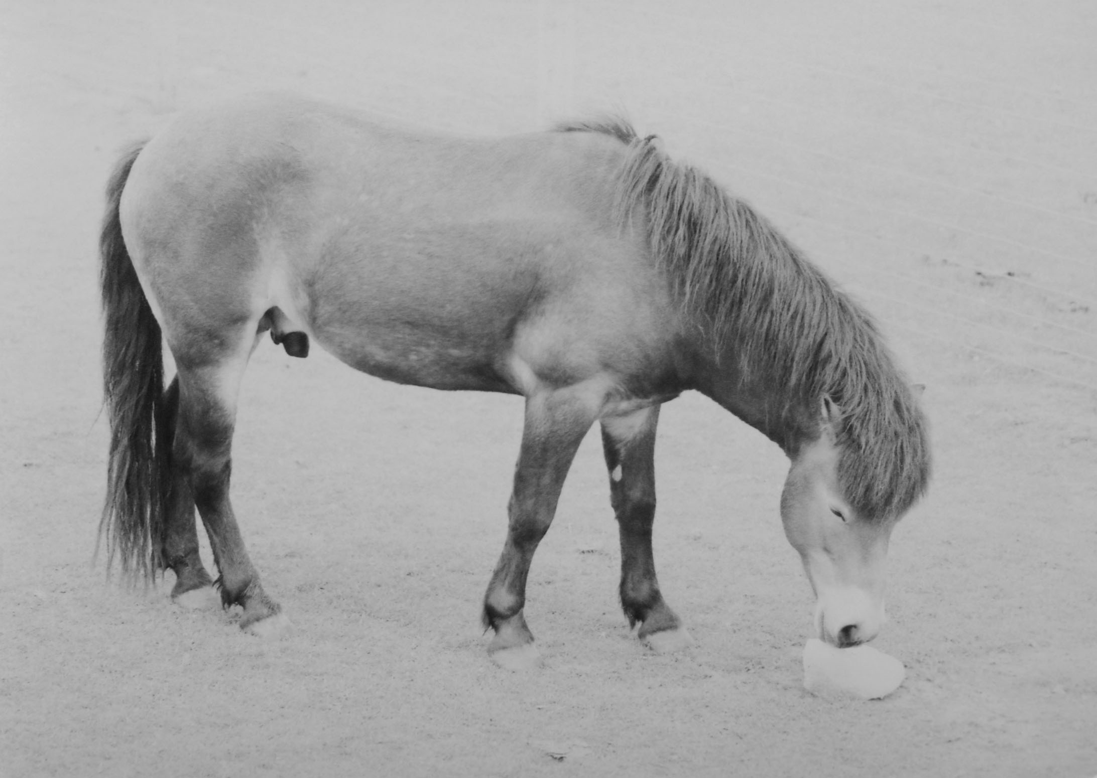

here's 3 pic's, taken with Canon 1D/ 50mm, and made B&W.
Can;t remember filtering on originals, I think the building might just have had yellow, and the horse (?) perhaps green.

The first two prints do not look right to me and even the thrid is only just approaching acceptable. It might be the lab. Can you remember which lab printed these?

from the pics you posted i can see your concern. do the pictures on the screen resemble what you're seeing in person? if so, there is a large lack on contrast, especially in the first 2 images. also the first 2 are a little light, but no way to tell if its the negative and/or print that faults, although with b&w printing ive been able to make a nice print from a negative 3-4 stops over exposed.
Yeah, the pics are what I see.

The main defect in all the shots seems to be muddy highlights. Contrast is reasonable, so development is probably close to right. More expose might help - try EI 320 or even 250 for a few shots, and see if it makes a difference. Expose the same shots at 400 also so you have something to compare to. Or it may be the lab. Most inexpensive labs use automated systems to judge print exposure, and they may not be optimum. Pro labs will work with you, but they are quite expensive.
