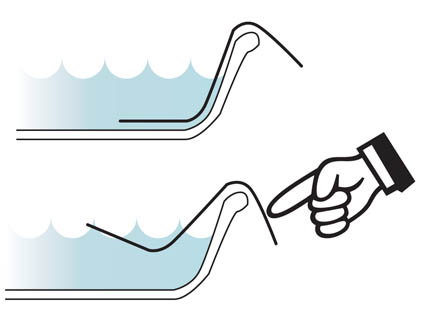

Something like this?? I'd buy one.
attachment.php

Yes, something like that.
Actually I thought of an "U" that sits vertical in the tray with the vertical parts protruding upwords at corresponding walls.
If you bend the horizontal, immersed part in a wavy line, the whole thing would sit stable and would hardly harm the paper when lifted.
Alternatively to steel one could heat-bend the same shape from a plastic rod.
