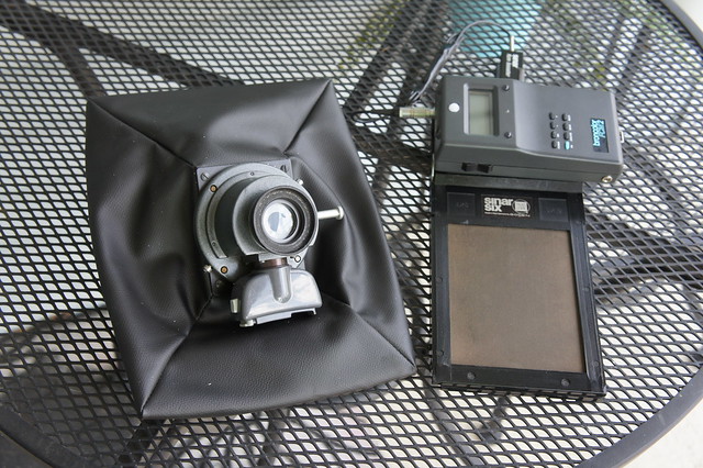

Plaubel Peco Profia TTL Metering Setup by Nokton48, on Flickr
This is a 1970s-vintage Plaubel Peco Profia TTL Metering Attachment, with the appropriate fully functioning Gossen Luna Pro. The meter is reliable and appears to be working perfectly.
This attachment goes onto a Plaubel Peco Profia Bag Bellows Viewer, which attaches behind the ground glass. To meter through the camera, you first press the black metal tube (on the right side in the photo) onto the ground glass, you can see the glass highly magnified, and select an area to be metered. The push all the way in the long silver rod on the unit, and activate the Luna Pro with it's rocker switch, to take and lock in a light reading.
Is anybody here familiar with this unit? I would like some help in getting accurate exposure readings with this unit.

Nokton, I was even unaware of this Plaubel TTL device. What is that circular(?) plate for?
By the way: the adapter to attach the Gossen meter to the eyepiece is the Gossen Profimicro Adapter

Dan, does this long silver rod activate meter or it just brings in prism or mirror and then you activate meter with right hand?
Hi Goran,
The silver rod pushes a front surface mirror into the path of the meter cell. So it's a two hand operation. You move the mirror into the path, then hit the rocker switch on the meter to take and hold a reading.

Very interesting contraption Dan! Can you use SinarSix to Plaubel?Good luck with it!
Goran,
Yep all my Sinarsixes will fit other view cameras, including my Peco Profias.
They did not make that much stuff for the Peco Profias. I'm trying to find all the bits and pieces.

Nokton, I was even unaware of this Plaubel TTL device. What is that circular(?) plate for? /QUOTE]
This entire unit attaches to a Peco Profia Bag Bellows for viewing. BTW there is a similar plate with magnifying lens, which allows the entire 4x5 screen to be viewed as from a monocular. And it works very well, I enjoy using it.
So snap off the circular viewing monocular, and snap on the TTL Meter mechanism and set exposure through the lens. Especially valuable when using extensive swing and tilt, it meters lens light falloff, which is valuable info.

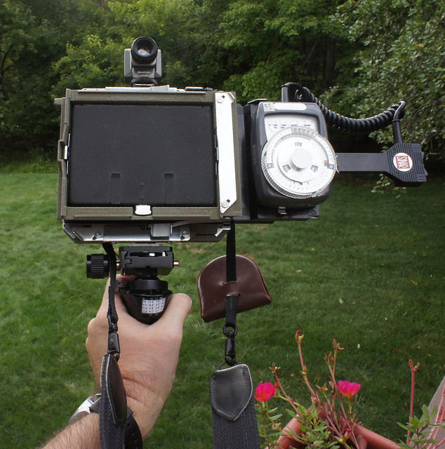

Sinar Norma Handy w TTL Sinarsix metering by Nokton48, on Flickr
I have found another use for my Sinarsixes! :smile:
This is my homemade Sinar Norma Handy camera, with 65mm f8 Super Angulon. Reading TTL with the Sinarsix through the camera, at EI 250 HP5+ I am reading EV9 which equates to 1/125 at F8 on a heavy overcast day.
This in my experience is a believable light reading. And on bright days it will read through the center filter and I can read all four corners TTL
