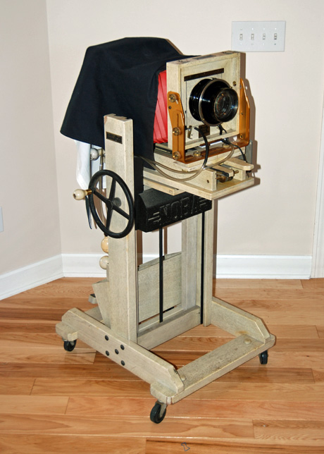

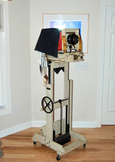

Stephanie,
No sure where in IA but I have a Noba 5x7 with a 4x5 rotating reducing back and 5x7 back with a sliding attachment to take two portraits on a single sheet of film. It also has a full studio stand. I bought it for the lens attached and I already have a Century Studio--I got the look when it came in the house. The camera is actually a beauty. Every movement you could think of and the stand works wonderfully. The bellows is taped but fully functional. It also has (and this is a really nice feature) a packard shutter with both instantaneous and bulb settings flash synched! You could mount anything from a 4" diameter barrel lens to a pinhole on it with flash. Travel through IA is frequent and depending on where you are, delivery is possible.
