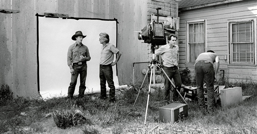

Because of the setting (it'll be in my mother-in-law's back yard) I can't really set up and dial in lighting, other than maybe a reflector. But thank you.
Avedon just used natural light for his In The American West portraits, shot on Tri-X. He did bring white seamless for a backdrop, but that would not have affected the light on the subject much.
