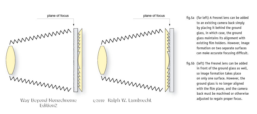

...I don't know how to tell if it goes on the outside of the ground glass or on the Film Holder side of the ground glass...
It can be done either way (see attachment), but it is important that the plane of focus on the ground glass exactly matches the film plane. In other words, adding a fresnel to an existing system is easy, just put it behind the ground glass (fig.5a), but if you want to put it in front of it (fig.5b), then the camera back has to be machined to make room for the fresnel thickness.
The setup in 5b has the benefit of fresnel and ground glass having a combined plane of focus. The setup in 5a is simpler, and it works, but it can cause double images and a bit of focusing confusion.

Thank you all, this has been very helpful. I will try without one initially but probably end up getting one at some point, just to see if it makes a difference for me. I wasn't sure if one was needed or not though I did know they brightened things up. The attachment explained a lot to me as well. I think my Omega is designed to have it on the back side of the gg; there are a couple slots there and I'm betting that if I use one, I want it to fit into those.
