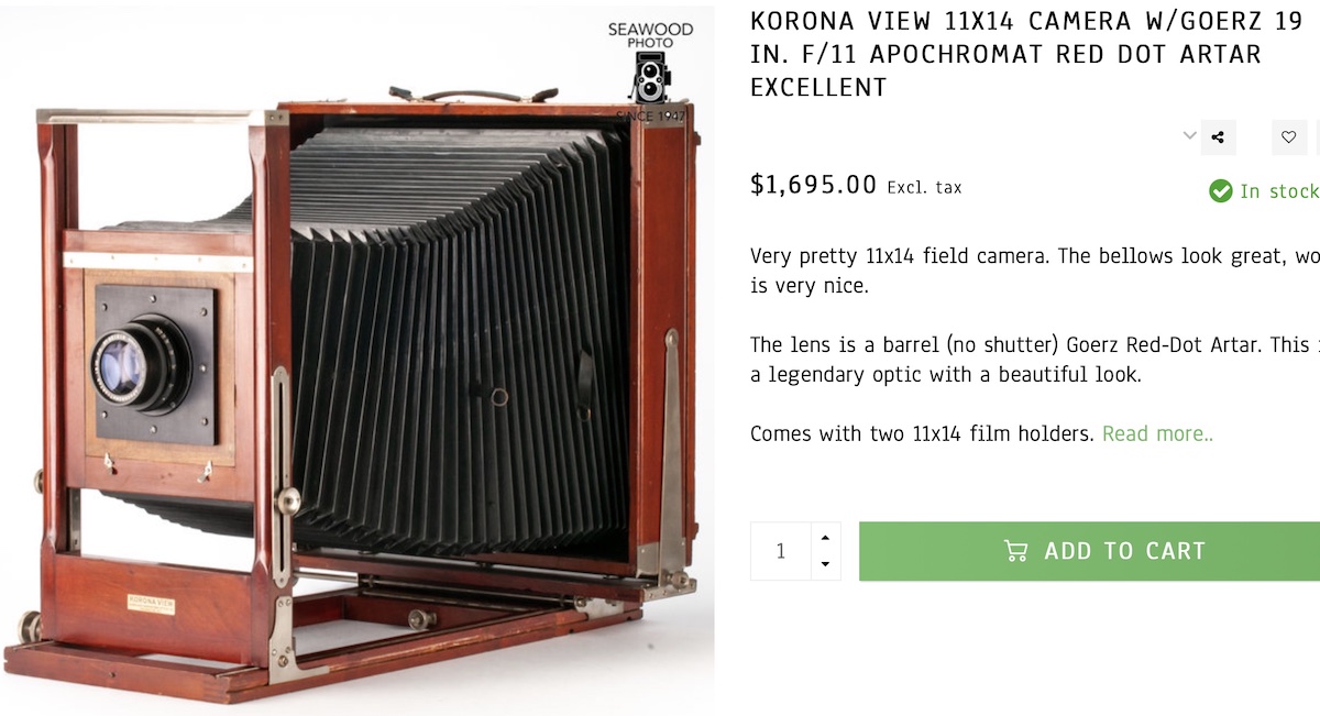

I would talk to one of the companies who make an 11x14 camera. Get them to fabricate a 12x12 back for it and then a holder or two for the glass plates.
The people who make wet plate cameras probably know all the details for making a proper glass plate holder and possibly the back for the camera.
Basically, there is almost nothing stopping you from going with a suitable 11x14 camera as a starting point and use a relativly simple reducing back of whatever dimensions you wish. No need to go fully custom here, but of course, you certainly could.
I'd be thinking of a Canham... but there are a lot of others that would be suitable, as well.
Yes, you can probably get an 11x14 camera for reasonable price and just need to fabricate a back and holders. A custom camera built is likely to be very expensive.
