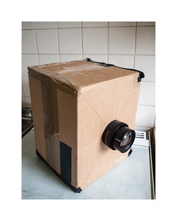

Once I worked out that you unscrewed the flange to mount it, I looked around for a quick way of making it take a picture. Fortunately, the box in which it was sent to me was about as deep as the fl ... so obviously, 5 minutes later I'd come up with this ...
10x8 Film holder slides into the back through a slot in the top at the back. Not light tight so has to be loaded in darkroom and covered up with a t-shirt before taking photo.
No shutter. Made a lens cap out of a circle and strip of cardboard and some duct tape.

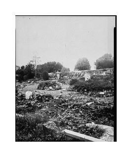

and a bit later I came up with this. There's something horrid going on with my paper negs at the moment hence the nasty spotty mess. Yuk.
b20140425-1 on Flickr

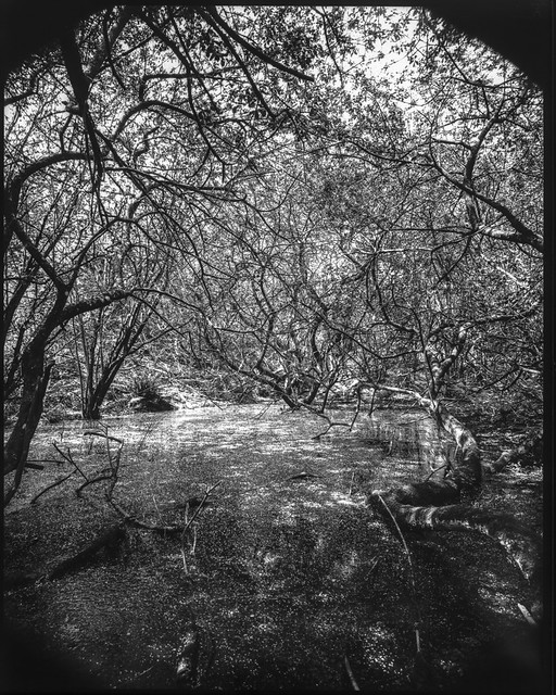

I found I had enough materials to assemble a foamcore box and decided to build one around the Repromaster 150mm.
It isn't the best choice lens, as although I have a flange for it, the thread depth on the lens is very short - only about 5mm - which means one can't be too innacurate about positioning the front board, as there's almost no room for manouevre in shimming the lens. Of course there are plenty of solutions, if one has the materials, skill, tools and whatnot, but part of the point here was to do as much as possible with as little as possible.
Anyhoo, here's the final camera, and an inverted scan of the second paper negative I got out of it (about 45s @ f/64, on some old Kenthene g2 someone found in the back of their garage, EI3, metered off middle foreground).
20140516-1 by _loupe, on Flickr
Not too bad, I think.
A heavy vignette as expected, and it does look as if I haven't got the lens vertically centred (the vignette is greater at the top than the bottom (or, I suppose, the bottom than the top)
