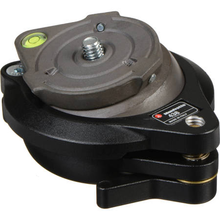

As for a strict leveling base, I have a Manfrotto inverted bowl leveling base (medel 438) on a Zone VI "lightweight" wodden tripod. It gave 15 degrees of movement, so no dutch angles, but it was quicker than leveling the tripod with the legs only. I put a Manfrotto hex plate on top and it worked well, but a while back I switched from manfrotto hex plates to arca swiss type plates (it seemed a little silly to mount a hex plate on the bottom of an Arca Swiss monorail.) Thats also about the same time I switched from Manfrotto legs to Gitzo legs.

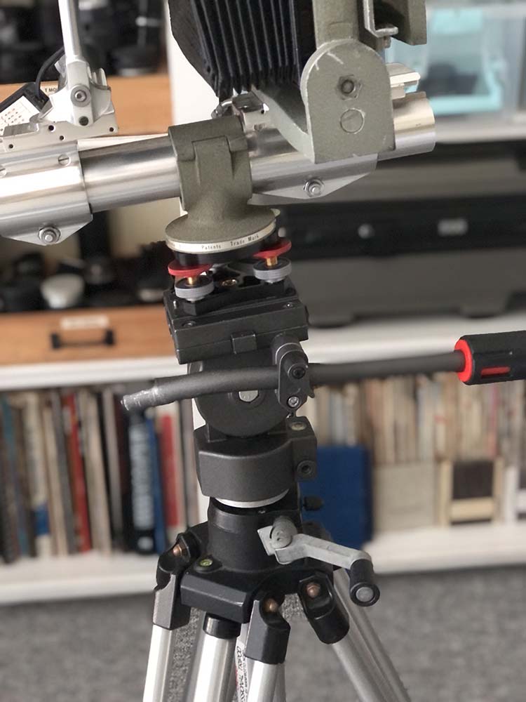

For my 8x10 Sinar Norma, I use one of these. The mounting pad is almost the same size as the camera tripod mount base, but I find there is ample contact area for a firm connection.
I have the leveling base mounted on to the QR plate of a simple video pan/tilt head on a Bogen 3046 leg set. Heavy, but very rigid, even with a big lens and significant down tilt on the tripod head. I find that the higher weight capacity and simplified movement set of the video head is great for large format. Down side is weight.
Here's a shot of the set up:
