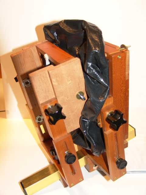

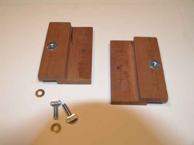

Here are some photos of the extension plates I built to use wider angle lenses. The design allows for some front tilt. I have used it sucessfully with 75mm and 65mm lenses. The 90mm works fine with only the bag bellows and the two standards to the front of the tripod block. It has never been a problem. The materials cost about $8 US.
Have fun with your Bender! Let me know if you have other questions. I have been using mine for about 9 years and have found that having a setup that is light and fits into a daypack increases the chances that you will have it with you and will take more pictures.
Doug
Doug
Great! Many thanks for posting the pics. I guess my woodworking skills have to improve quite a bit before I can attempt that but it certainly seems doable.
-Anupam
