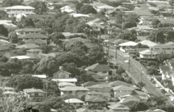

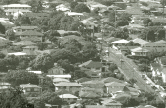

No matter, the film's been done and the lenses tested, and some intriguing observations arise. The ED AiS version and the AF EDIF version of the Nikkor 180mm both exhibit a very slight focus shift when used one stop down, wide open and three stops down are precise, and the shift is consistent over medium to long distances. The older, P version does not have this shift. Sharpness among the versions was not an issue, with mostly minor variations. I've done some scans and will figure out how to post.
Ok, here goes. Crops are from mostly center. F4, tripod, cable release. Image sharpness is reduced due to more haze than usual for Hawaii, I'm certain that I can squeeze out a sharper image with more fine detail.

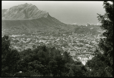

Here's the full neg image. Sorry, first time posting, still trying to get the sizes right. Scanned from print, no sharpen in PS nor on scanner.
