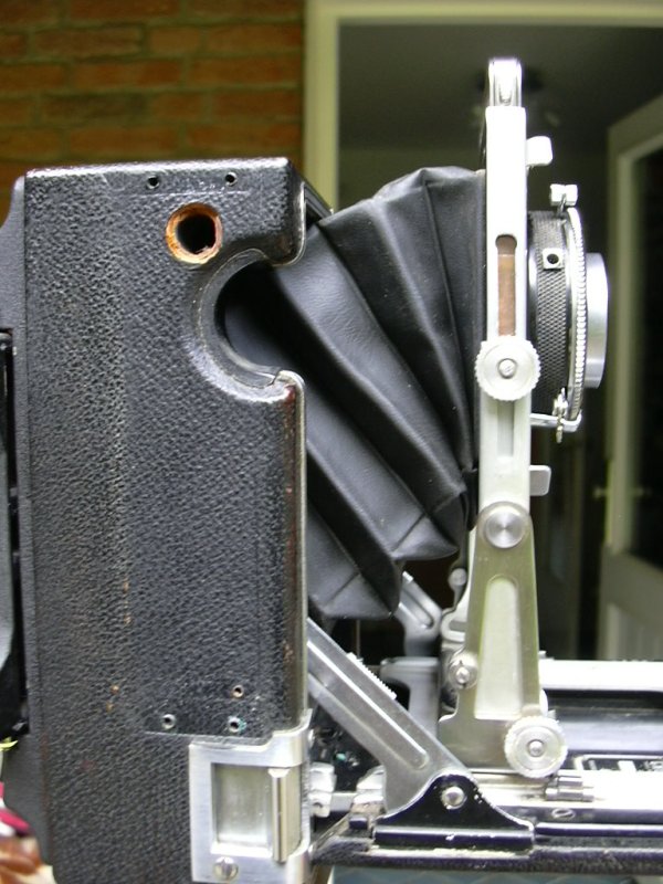

Hi,
the camera is not exactly LF but the question about my problem may find a more knowledgeable audience here. So I hope this is ok.
I plan to use my little crown with a 6x6 back which I hopefully receive on Tuesday. (This is the largest format I can print so 4x5 is not an option for me, as anybody asks :wink: ).
I have pimped the front a little bit so that it has about 45mm rise. This is important for a long term project on trees I have i mind. This works great with the 101mm Raptar. But 101mm is a little bit long for 6x6. So I am in need for a shorter lens.
I see two options at the moment:
f1:6.8/90 Angulon and
f1:8.0/65 Super Angulon
I have not the least idea what the distance between lensboard and groundglass will be (at infinity) with these two lenses; especially whether the 65mm will fit at all.
I'd rather have a lens of about 80mm. The more modern 5.6/75 Super Angulon will surely not fit. Is there something smaller in that range?
Ulrich
PS: Before anybody asks:

I like a 80mm f2.8 Xenotar on my Century Graphic. It covers 2x3, so since you are only shooting 6x6 you will have a little movement. Its a wonderful lens in many respects.
However, since you mentioned you were working on some tree projects, it sounds like you are looking for something with alot of extra coverage. A 90mm Angulon should do you fine. The 65mm f8 super angulon would also be a good choice, and it will fit nicely.

My main problem is not to get the lens into the board but not to loose my newly gained front rise. As the distance between rear element and groundglass is too small I will not be able to rise.
So I am looking for the shortest lens that will just keep clear from the top of the case as I rise the front at infinity.

Since those cameras are worth less and less each year, simply use a jig saw and cut back the top a reasonable distance and use a piano hinge to fold back the top peice. Don't let the body stop you from using a shorter lens. Btw, Dan is the man in 2x3.

I have a (modified) Century and also a 2x3 Speed. I've used down to a 38mm on these too, but mine is a Super Angulon XL. This requires the trick of taking off the rear cell and then refitting it from the back: it is a nuisance, but it does work. In fact, once it's fitted these are rather nice cameras to use with this lens.
Both this and the 47mm SA end up inside the body and limit your rise potential unless you carry out some modifications to the camera. The 38mm has such a large rear element that you can't move it much in a 2x3 camera anyway because the bellows can't accomodate it, but the 47mm allows quite a lot of movement.

Whether this will be an option depends on the amount of rise I will need. The gain in rise by removing the framefinder is only 15mm (compared to nearly nothing without). With the closing mechanism removed it will be 18mm.
If the modification is done properly, cutting the top will be just a modification of the camera not a destruction. Being a cabinet maker I know that I can do it properly.
Ulrich
PS The real problem is the rear element being in the way, not the front standard

I just yesterday bought a f8/65 Super Angulon made about 1963. The diameter of the rear element is 42mm and the distance between filmplane and lensboard is 70mm at infinity. I think it will perfectly fit my little crown.
Thank you all for your help
