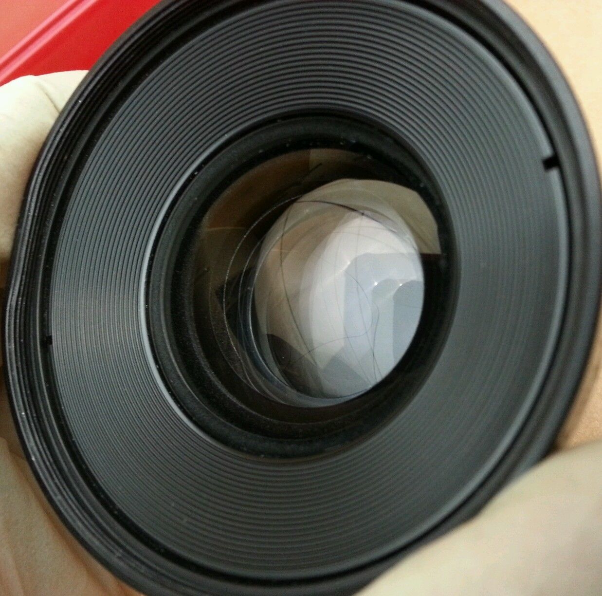

I have 2 identical lenses (Caltar Type-S 150mm on Copal #0 shutters) that both have issues. One lens has a weak shutter and the other has a small ding on the filter ring so that it won't take a screw-in filter. I'm thinking I could swap the front and rear elements so I end up with one lens with a good shutter and no ding, and another lens that, well, would be less desirable. Does anyone think that would pose any problems? They are re-badged Rodenstock Sironars and nice lenses.
This is the ding mentioned above.

He's planning on switching both front and rear, to the better shutter. It's not going to be a problem for him.

Personally, I am chicken when it comes to messing with a fine lens. Contact a competent repair person and find out how much the swap would cost. If it is a lot of do-ray-me, you might not want to do it as it would not be not easy. I'd try to fix the other lens, first.

Swapping pieces is the best idea if money is a concern. If not, you could search for a cheaper version of one of these to straighten the ring:
http://www.soonwell.com/goods-210-R...r+Ring+Professional+28mm+to+105mm+Steel+.html
Here is an old APUG thread:
Here is an interesting DIY approach, using a vice or wood clamp, and similar ones using a hammer.
http://feuerbacher.net/photo/repair/FilterRings/FilterRings.html
https://www.youtube.com/watch?v=JCCx7rSwC3s
http://www.kyphoto.com/classics/filterringtool.html

Do it! Do it! Do it!
Well, that didn't take long. Thanks for all the advice. It seemed to be a simple fix, but I didn't know how workable. I think I'll swap both the front and rear elements. The only thing that worries me is Mr. Walrath seems a bit TOO eager. Maybe I'm reading too much into his comment. Anyway, thanks for the help,

take a block of wood and carve a curve into it. place the bent ring onto the curve. Take another piece of wood, shaped like a chisel, and carve it rounded on the end so it matches the curve you want.
Carefully tap the chisel onto the dent as it rests on the other pieced of wood so yu gently hammer the dent out. I saw actual professional camera repair people do this once. You use wood so you don't mangle the lens.

Final plan of action: I sincerely appreciate all the advice here. Gonna swap both the elements and get some use from the best parts, and when I can fit it in the budget, I'll send it to either Flutot's or SK Grimes and have it CLA'd and fixed.
