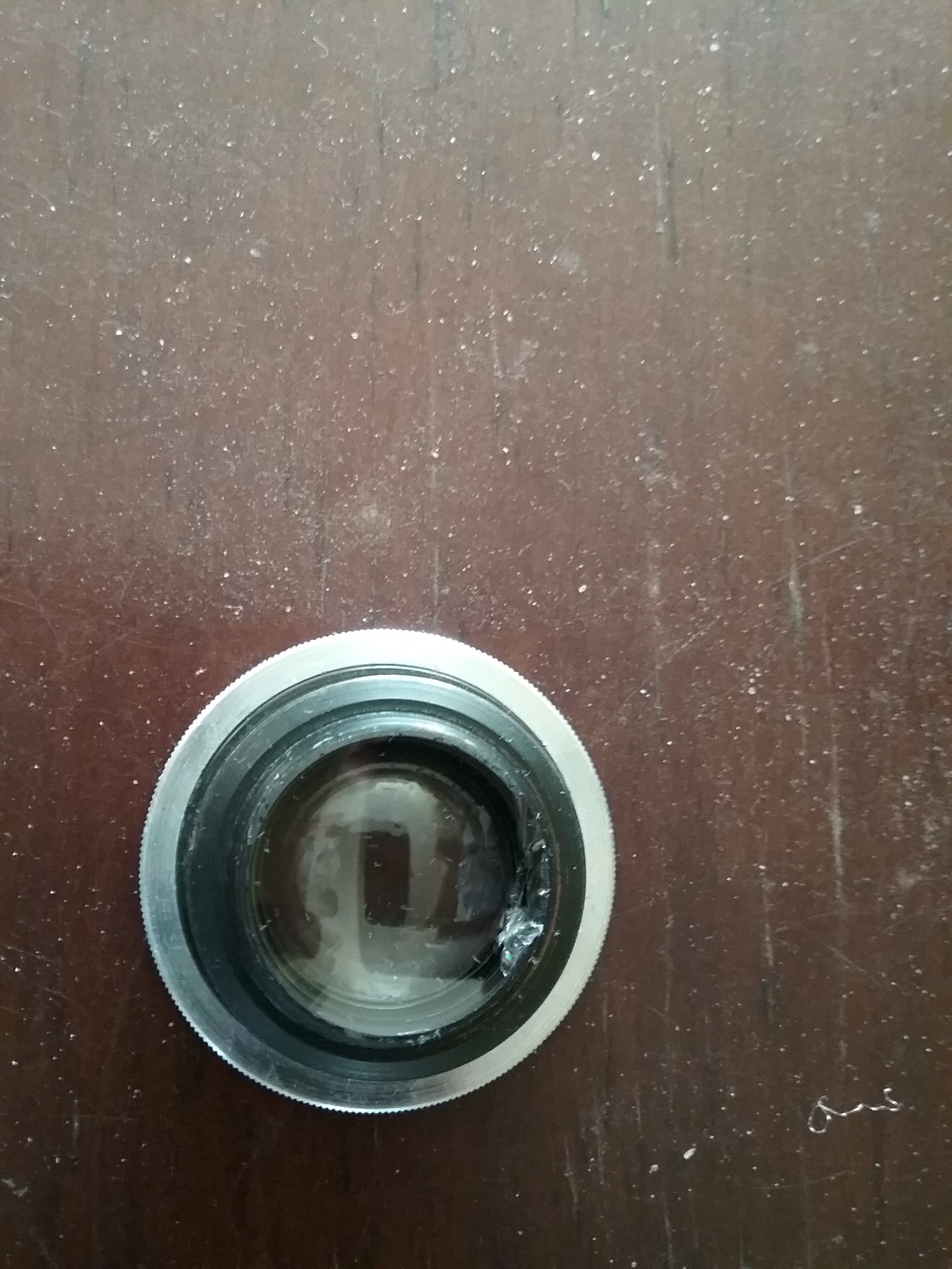

I have a lens with a chip on a cemented element. Can anyone recommend a reputable repair person in U.S.?

Sorry to be negative, but your best bet is probably to get a better example. Second best bet, if you can get to the chip, is to blacken it with, e.g., India ink.

I forgot to post a photo.here is the lens

What is the lens?
Try India ink. Inexpensive, can be removed.

Sometimes when I do a repair like that, the donor lens is nicer than the broken one. In which case the broken lens gets some black paint on the affected area and is put aside as a spare. The donor lens is cleaned, re-assembled and put into service.

Do you repair personally or for others? The lens is an AGFA 105mm 4.5 SOLINAR.

Hmm. If you replace, you'll replace the entire rear cell. This because the rear group is a cemented doublet that appears to be swaged into its mount.
The Solinar is a pretty average 105/4.5 tessar type, but not as common as many other similar lenses. I have no idea which camera it fits, but quite possibly other 105/4.5 tessar types will fit as well.
But first try India ink.

Dan,the lens is a 105mm 4.5 solinar,I have posted a photo of the damage.

I have lenses that are older than that with worse damage around the edge, and as long as it is on the front element I use hem as is, and no problems as long as you use a lens hood, I even have a old filter that got dropped and has damage much the same as the damage on your lens and again never cause problems or show up on negatives or prints so I would suggest that before you spend loads of money getting it repaired you try it as is, and if that fails the get a sharpie and carefully cover the damage

What would the possible effects be if left as is vs india ink?
You'll have to ask the lens to be sure. I have several lenses with similar chips, the usual effect with them is severe flare.
Thanks for the reply. Y'r Billy wants a Solinar, no other tessar type will be a good substitute.
If it doesn't have sentimental value, consider replacing it with another or with a Kodak Tourist with a 105/4.5 Anastar in Flash Supermatic. The Tourist's one drawback relative to the Billy is that it uses 620, not 120, film. The usual solution is respooling 120 film.

....... Y'r Billy wants a Solinar, no other tessar type will be a good substitute.
Is that because the flange focal length is...mmmm, unique? or something else?
I have (or used to have) an old Franka Rolfix with a 105mm lens, I think it is a radionar ??? but, it would not suit the OP's application...Is that correct?

Brad, that's right. There's no guarantee that any other lens' flange-focal distance will match the 105/4.5 Solinar in Compur (probably #0, but not guaranteed). That's why the Radionar (a triplet, which is irrelevant to this discussion) probably won't do.
Thinking of the Radionar, if you've shot it how does it do? I ask because many many years ago there was a sort of running joke about Radionars in, if I'm not mistaken, Modern Photography that used to be. The MPers regarded as a lens that passed light and formed an image, but never a good enough image.

For myself, I would either use it as a bookend or paperweight and buy a replacement that is in much better condition. I would rather replace something like that than spend time making a less than perfect repair.

It is in otherwise pristine condition that is why I would like to have it to be useful. An alternative I am going to try is to find one for a reasonable cost on E-BAY. That is where I bought this one for the very reasonable cost of $37.00 shipping included.
